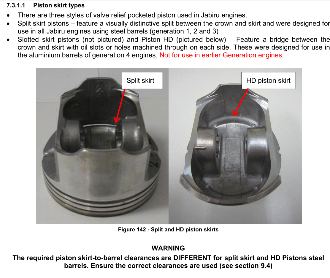

Thruster88 Posted January 22, 2021 Posted January 22, 2021 Just now, RFguy said: There is a Gen 1,2,3 piston upgrade available now, also.... Have they been tested or is that your job Glen?
RFguy Posted January 22, 2021 Author Posted January 22, 2021 (edited) ha ha. No. They have sold one batch, something like 150 pcs.. Next batch is due next Feb some time. I understand they are uprated like the upgrated Gen4 pistons. Not sure what they got for the skirt slot, or not. Edited January 22, 2021 by RFguy
facthunter Posted January 22, 2021 Posted January 22, 2021 I would NOT be running a slotted piston in an application like this. They are never used in anything but a touring type motor and are likely to collapse and lose size if overheated, Short conrods make it less suitable as there's more side thrust on the piston. Nev
RFguy Posted January 22, 2021 Author Posted January 22, 2021 (edited) the Gen4 HD pistons (the 'upgrade') have solid skirts and more meat in the skirt. no slots. I am not sure if the new HD pistons for gen 1,2,3 have slotted, split or solid skirts. at a guess I'd say they are solid. these new pistons have been around only since December 2020. image below from older overhaul manual : Edited January 22, 2021 by RFguy
RFguy Posted January 22, 2021 Author Posted January 22, 2021 there is of course more discussed on this topic in this previous topic. However a new HD piston for Gen1,2,3 didnt exist then. :
facthunter Posted January 22, 2021 Posted January 22, 2021 (edited) It's probably adaptable if the clearance is increased because of the steel material not expanding with the piston, as much as the alloy does The steel is also a worse conductor of heat. Retro fit would permit a degree of honing to be done to the cylinder to achieve the required clearance, WHATEVER that is.... It would have to be established. Resizing the piston is not practicable with such a small amount to be removed as it is oval and tapered. You might also find the ring gaps excessive . Nev Edited January 22, 2021 by facthunter

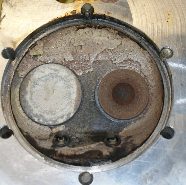

RFguy Posted January 24, 2021 Author Posted January 24, 2021 (edited) OK all you old engine people : So got the heads off, I will post some pics when have downloaded them. What is the yellowing on (some of) the gunk on the piston tops ?, generally on the lower and rear side From what I could tell yesterday, It looks it is where oil migrating up into the carbon and gunk when engine off on the lower side of the cylinder blots up into the carbon on top of the piston. There was a small pool (a few drops) of oil on the lower side on #6 Hot cylinders had far less gunk buildup than the cooler cylinders, which I guess you'd expect Couple of cylinders have ring gaps lined up perfectly.... All I would think a fair amount of clearance. around 6 to 10 thou at a guess by rocking with my thumbs at TDC Exhaust valves on generally dark brown in the middle, lighter brown on the outside. hotter cylinders have darker middles. Closed valve heights look OK, plenty of seat there. will know better when I get the chambers cleaned up a bit. Will take exhaust valves out and Xray and microscope them at the lower stems . Might make up a head valve vac tester Edited January 24, 2021 by RFguy

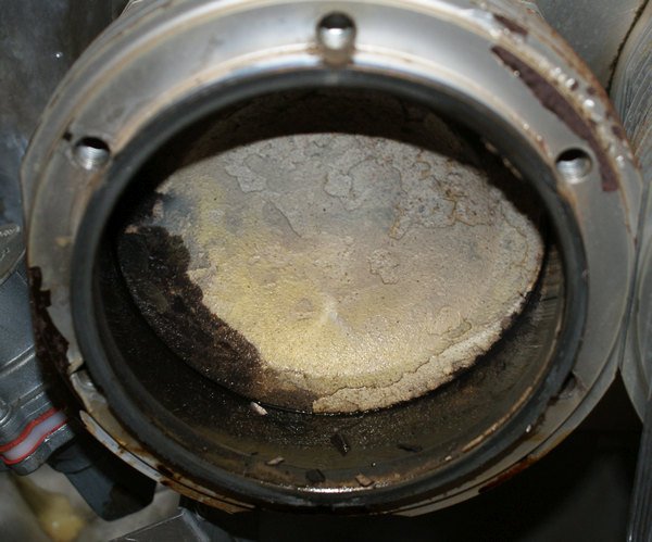

RFguy Posted January 24, 2021 Author Posted January 24, 2021 (edited) continued from above chamber, CYL 2 cool one, CYL5 (hot one) ,, and the yellow ish #5 piston Edited January 24, 2021 by RFguy

kgwilson Posted January 24, 2021 Posted January 24, 2021 That would explain excessive deposits. It is hard to tell but are the pistons valve relief models?
RFguy Posted January 25, 2021 Author Posted January 25, 2021 yes, there is a valve relief just visible. MarkD hypothosises that the yellow is Lead Chromate - the chromium comes from the bores. The 4140 is 1% chromium.... Oil analysis might be interesting.
Kenlsa Posted January 25, 2021 Posted January 25, 2021 RF, Yellow/whiteis result of avgas residue. All our club Jabs are on 98 now due to avgas residue forcing us to lap valve every 150 to 300 hours Wire brush it all off with a brass rotary brush on a drill- piston tops (you may scrape them with a small steel ruler to reach inside if the cylinder is still attached to the case) and combustion chamber- and the lower stems of the valves.( This will be very hard and may need machining -see below) if you see small grey spots on the valve and/or face -that is lead. use a factory go/no go gauge on the valve stem guides. It may be too tight. If so BEFORE deciding on new guides, ream out the hardened carbon with the factory reamer (I forget the size), you will be surprised what come out! then recheck the go no go gauge again. You almost never need new guides. take the valves to get recut at an engineering shop.$10 per valve. Then lap in the valve to the seat (again, you probably don’t need to cut the seat as well, just a lap will be ok) Oil and reassemble , with same collets to valves DONOT mix them up. then torque to 24lbs. fly for 5 hours and then re torque.... ring me if you want Ken 1
facthunter Posted January 25, 2021 Posted January 25, 2021 If you have nitrided valves don't reface, replace. The hardness is not very deep. Some of those inserts appear to be loose in the ally. Heat the head and check if they prise out. That's a lot if deposit. Some of it is often fine dust. Are there any scratches in the bore? Nev

facthunter Posted January 25, 2021 Posted January 25, 2021 This amount of engine fouling is not good. Those build ups can incandesce and cause pre ignition and engines running on.. Also the top ring land may be carboning up, which could cause ring breakage like in 2 strokes. Water Meth injection on take off may help clean it up. 100LL is a problem for the Industry. Originally a bromine compound cleared out the left over lead. It caused the white exhaust you don't seem to see now. Bromine is really toxic. Nev 1
