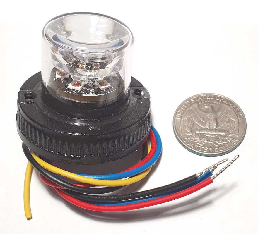

Tasmag Posted October 14, 2024 Posted October 14, 2024 this might be a cheaper option, seems to be the same thing. (I suspect this is the original provider) I have one on my aircraft and it works a treat https://www.superbrightleds.com/vehicle-lights/emergency-strobe/led-hideaway-strobe-lights/led-hideaway-strobe-lights-mini-emergency-vehicle-led-warning-lights-with-built-in-controller-surface-mount
RFguy Posted October 14, 2024 Author Posted October 14, 2024 interesting lens no specs on luminosity. limited on brightness I think on the small number of LEDs. but probably fine in the circuit on a dark night

Jim188 Posted January 1 Posted January 1 Hi All, Firstly, thanks to every one for your help and advice along the way with this thread, it's been a slow process in trying to workout how to get the Kuntzleman Tail Beacon apart, while still being able to put it back together again. Well on the Christmas Break, I finally lathed back all but the base of the tub from the Kuntzleman Tail Beacon. I then tried soaking the exposed epoxy in a couple of different solvent brews and not one soften this epoxy in anyway. So with OneTrack's advice in mind about it being nearly impossible to remove these types of epoxies, I have given up for now in trying to find away into the beacon electronics. So with this change of direction, I ordered one of the FlyLeds Flashing Beacon that Skipdiesel and Tasmag talked about, so thanks guys for your advice and help about this smaller Red Flashing Beacon. So I ordered one of these unit over the Christmas break and it happen to arrived on New Years Eve, so thanks to Flyleds who are in Australian and based in Victoria, thanks Paul. So at first glance of the unit, I was more than happy with the unit and even happier after I compared the Kuntzleman and Flyleds Beacon side by side for brightness. To me the Flyleds Flashing Beacon seems to be at least the same or even a little brighter than the Kuntzleman Beacon. So where to from here, I am thinking the best way forward is to redesign my 3D drawing to make up a mounting spacer/hub that can hold the new flashing unit into the top of our Jabiru's tail beacon shroud. Cheers Jim188 1

Jim188 Posted January 6 Posted January 6 Hi All, Well I am very please in how this Flyleds, Flashing Tail Beacon has worked with ease using the Jabiru tail mount. It's certainly brighter than the old LED unit and far less costly than purchasing a TSO approved Flashing Tail Beacon. Not taking into account my own time, but even with all the other bits I purchased in trying to repair the old Kuntzleman Tail Beacon. I am still under $235.00 all up with the Flyleds Flashing Beacon, I guess I am lucky having a Experimental Type Jabiru so I can use non TSO or certified parts. Thanks everyone for help and advice along the way. Cheers Jim188 2
