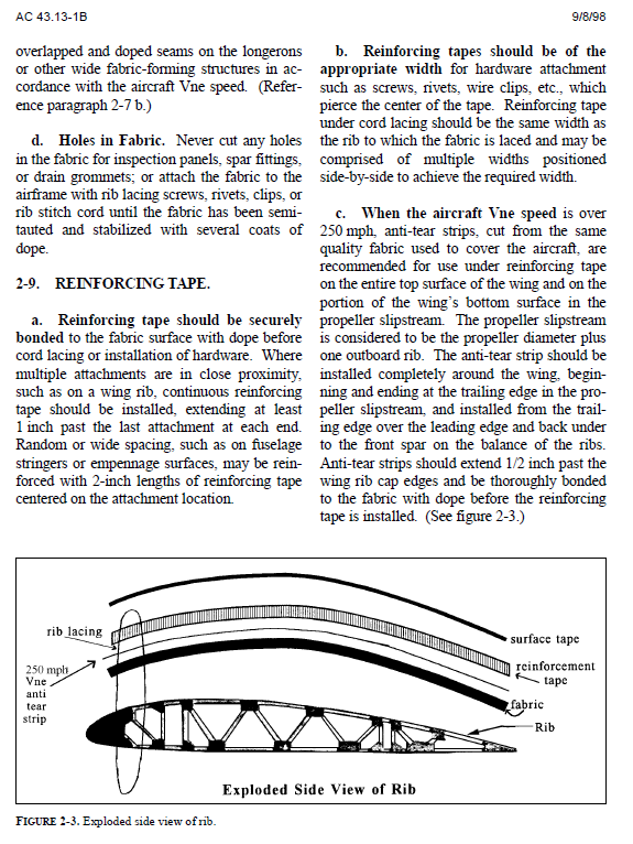

old man emu Posted March 3, 2021 Posted March 3, 2021 This is from FAA AC 43.13 and explains how to cover surfaces if the Vne is greater than 250 mph (~220 kts) 1

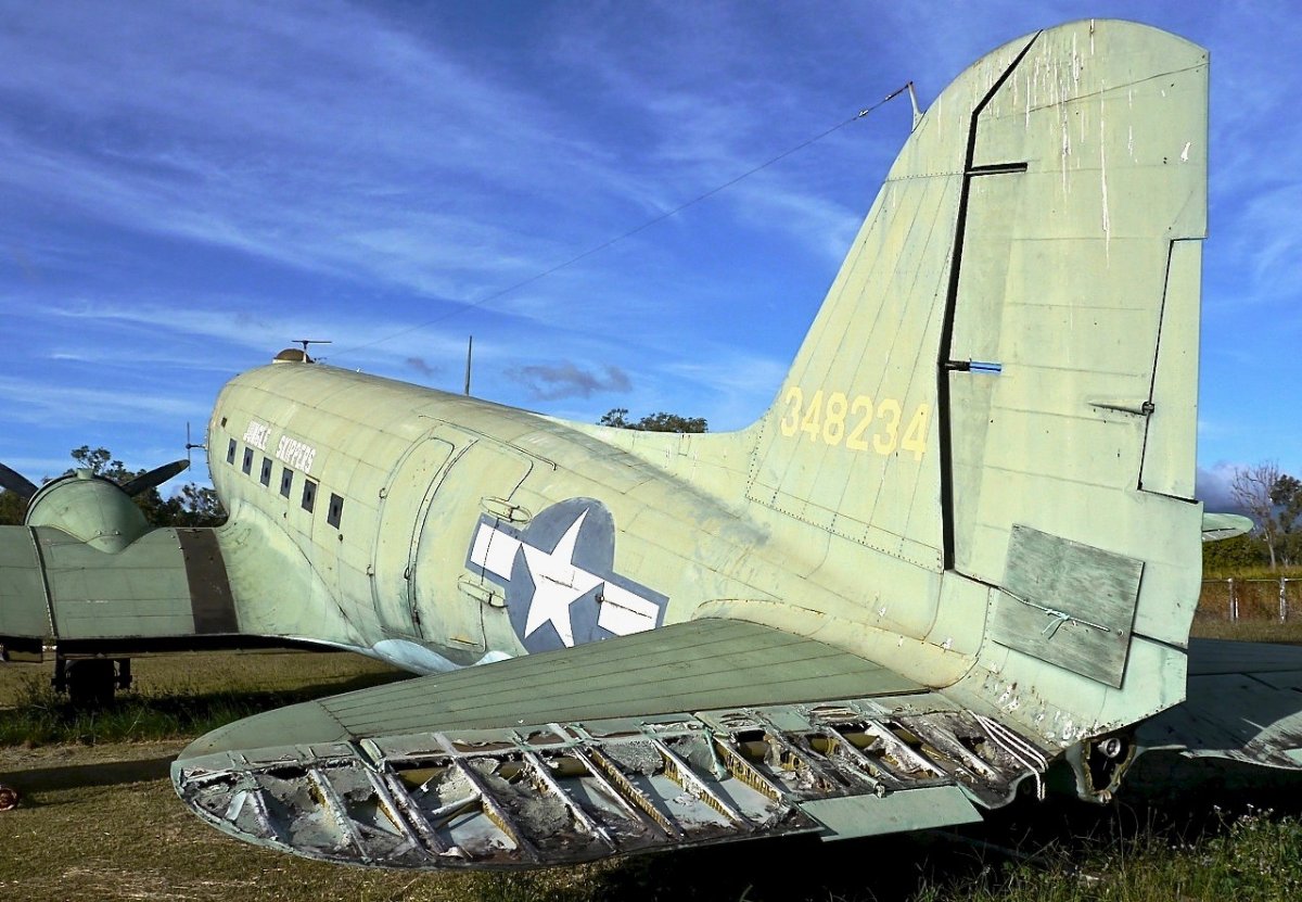

Garfly Posted March 3, 2021 Author Posted March 3, 2021 58 minutes ago, Student Pilot said: I have seen a pic of rows of Corsairs lined up after war in the Pacific, they must have been there a while as most of the fabric had rotted away showing the structure underneath. Like this C-47 that used to live at Mareeba. (And was being restored at Caboolture, last I heard.)
facthunter Posted March 3, 2021 Posted March 3, 2021 Nitrocellulose doped fabric wouldn't last 2 years in the sun. About 1960 they went to something a bit more durable. Butyrate. Ordinary dope made repairs very simple.. Nev
