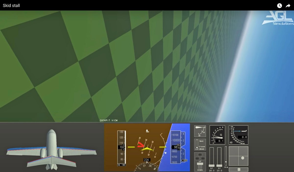

YouTube upload by:
AGL Simulations
A skid stall demonstration of a very light jet in a left turn.
Notice the rudder offset to the left causing slipping to the right and dropping of the left wing in the stall.
Quick unloading of the stick prevents the aircraft from entering into a spin.
A similar maneuver is performed in an Extra 300 in this video by Jari Halttunen: https://www.youtube.com/watch?v=RlvPw...

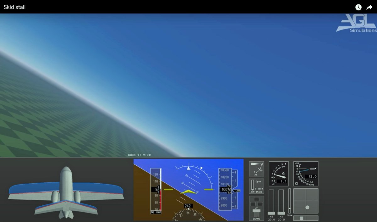

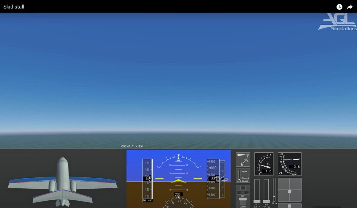

Keeping track of the stick and rudder positions (lower right) illustrates the recovery method discussed by Jari.
And these are some instructive screen-shots referencing the AoA indicator (upper right).
𝛂 = 0º
𝛂 = 12º
𝛂 = 3.8º
