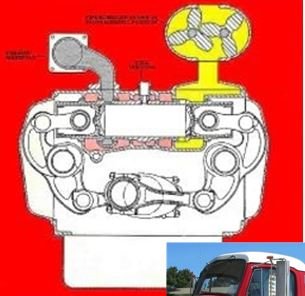

tillmanr Posted September 30, 2021 Posted September 30, 2021 Are you speaking of the Commer knocker? 1 1
BrendAn Posted September 30, 2021 Posted September 30, 2021 9 minutes ago, tillmanr said: Are you speaking of the Commer knocker? Didn't the commer knocker design come from a ww2 junkers aircraft engine. 1
spacesailor Posted September 30, 2021 Posted September 30, 2021 Looks like it is, but never heard of that knickname before. Far to complicated for a aircraft. spacesailor

BrendAn Posted October 1, 2021 Posted October 1, 2021 Commer knocker is naturally balanced with 2 piston moving opposite directions and sharing 1 combustion chamber but there is always a downside and with the commer it the complex system of converting linear motion to rotary motion.
turboplanner Posted October 1, 2021 Posted October 1, 2021 The Commer TS3 was Australia's linehaul truck engine for a brief period and worked well, but: It had the perpetual oil change requirement of the diesel two strokes of the day - leaked like a seive. You could hear them grinding along the highway at 80 km/hr from five miles away. The emissions were on a par with a steam train. CommerTS3.wav 2 1
