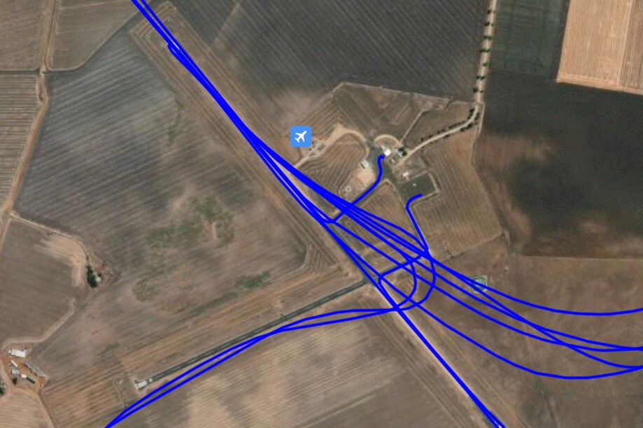

Old Koreelah Posted May 28, 2021 Posted May 28, 2021 On 10/05/2021 at 4:29 PM, Old Koreelah said: We could use our OzRunway tracks to check how accurately we fly circuits, etc. In the near future I plan to practice EFATO turn backs while at altitude directly over our airport, so that the OzRunways track are laid over the actual strips. Confined with careful recording of the gauges, this could show if my turns could have made it to the cross runway, etc. This morning I finally got to do this over 1000’ above our circuit. Was surprised to lose no more than 200’ during the two simulations and easily lined up the cross strip. OzRunway tracks seem to show I could have comfortably made it. Not advocating anyone ignore good advice, but the paddocks directly ahead are pretty rough and usually full of big black cattle.
turboplanner Posted May 28, 2021 Posted May 28, 2021 2 minutes ago, Old Koreelah said: This morning I finally got to do this over 1000’ above our circuit. Was surprised to lose no more than 200’ during the two simulations and easily lined up the cross strip. OzRunway tracks seem to show I could have comfortably made it. Not advocating anyone ignore good advice, but the paddocks directly ahead are pretty rough and usually full of big black cattle. I'm not advocating doing this physically in case something goes wrong, but now allow six seconds for "shock value" the this can't be happening/flicking a few switches etc. You know your distance per second at circuit speed and you can scale the strip quite accurately using Google earth. It would be interesting to see how much further on that curve starts. Also, with what's visible in the photo, would you really want to squeeze into the last part of the cross runway and risk hitting the fence vs straight ahead where you might experince some bumps, albeit having to steer through the cattle. Also there's the pre-knowledge where you set the engine-fail before the cross strip. What is your mind-set, having done all those simulations if on the very next non-sim flight the engine fails just as you get to the cross-strip. I've tried many different ways to really test myself for (a) an instant sub 50/100 reaction to do what I've drilled to do vs (b) the six second "why is this happening to me" delay, by telling the Instructor to pick a random time, randomly deciding the engine just cut, even getting someone to set a stop-watch alarm, but in all those cases, I knew I'd get a failure at some point so didn't make any mistakes. 1

Old Koreelah Posted May 28, 2021 Posted May 28, 2021 41 minutes ago, turboplanner said: ... now allow six seconds for "shock value" the this can't be happening/flicking a few switches etc. Valid comments, Turbs. A couple of seconds of “startle” time is built into this simulation, but every takeoff should include the Murphy factor. (Who was it that said we should not be surprised when the engine stops, but surprised when it doesn’t.) Those two turns were pretty leisurely; I could do better. As shown on the tracks, I like to drift to the left, just in case. A failure below 300’ means I should make it back onto the runway line and get down on the long gravel strip ahead. After that point I can turn onto the cross strip, but that “window” is pretty small. Beyond that window means coming down in a cultivation to the left of the strip. 41 minutes ago, turboplanner said: by telling the Instructor to pick a random time, randomly deciding the engine just cut, even getting someone to set a stop-watch alarm... Good points; I was lucky to have an instructor who surprised me with about 20 simulated power failures. That was years ago and the lesson is wearing off. 1
