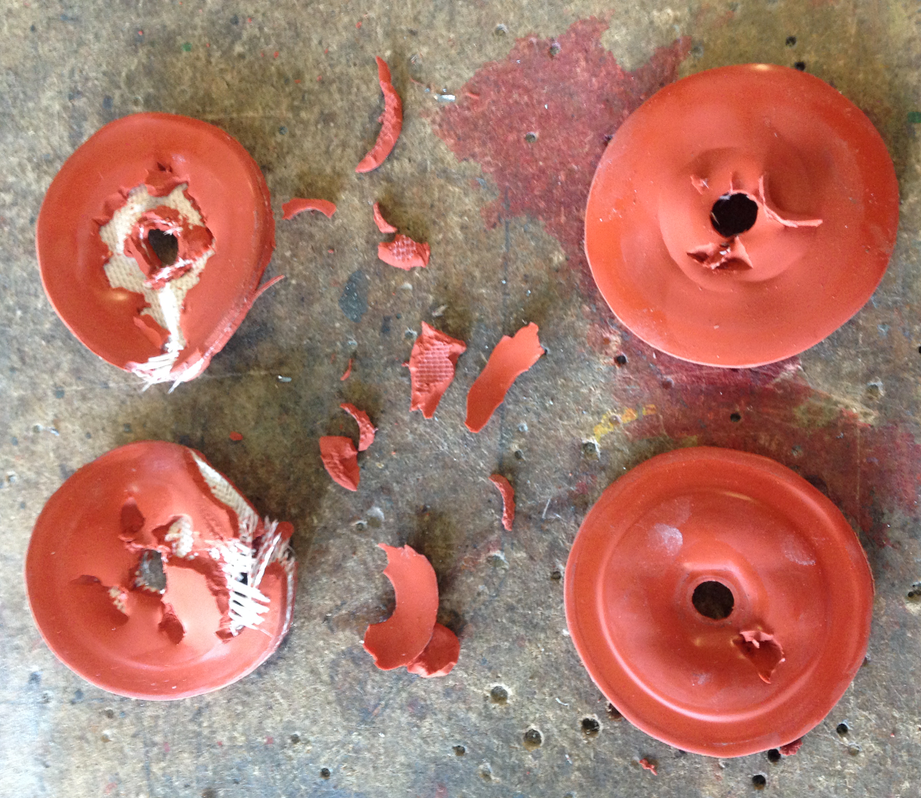

Just a heads up to people out there doing their own thing, orange baffle rubber (and I think orange fire-sleeve) does not like fuel and will break down.
History;

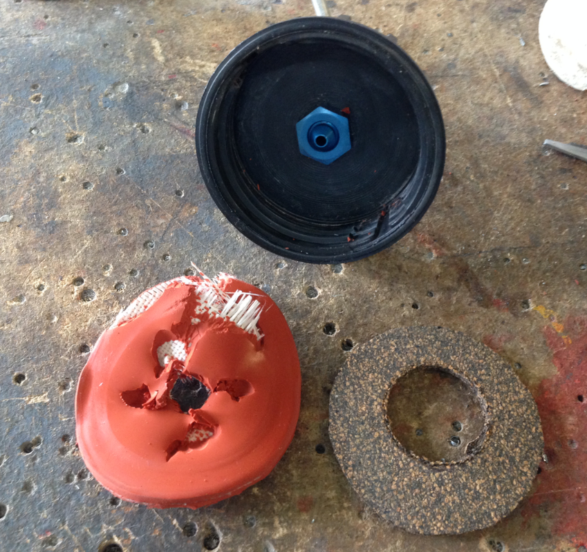

While refuelling a Savanah, I would typically unscrew the fuel cap and sit it on the wing next to the filler neck.
This one time, as I picked up the cap, I found a piece of orange 'rubber' sitting on the wing?
Looking under the cap I discovered someone had manufactured 'gaskets' for under the cap, made of glass reinforced baffle rubber (a neoprene I think), checking the other caps I found they were all falling apart!
New seals were made from rocker cover rubber/cork composite.
