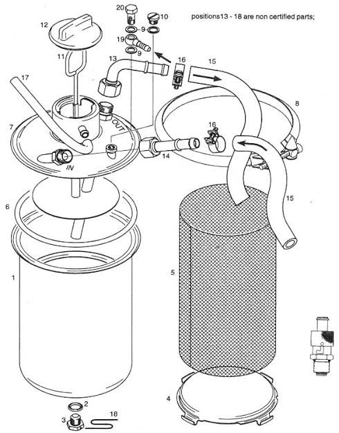

The rotax 912 oil system's that I have seen have these fittings, they definitely have barbs. You could get away with no barbs because all external oil lines on a rotax 912 have no pressure in them, suction or atmospheric pressure only.

How do you figure the oil lines have no pressure? If this were the case the oil would not circulate. The oil lines are subject to both negative (suction) and positive (return) pressures.
The point is not the pressure per say but the ability of the (low pressure) system to resit leaking (air in/oil out) and the hopefully reasoned choice you might make between the traditional multi sharp(ish) ring style and newer smooth pipe, often  fitted with a smooth ring/swelling, to do the job.
I agree that these fittings are designed for low pressure (not nil) as is the case for the fuel lines under discussion. High pressure lines require a very different engineering approach.
Check out the photos I provided above - other than size they are all similar to the Rotax fittings in your schematic.
