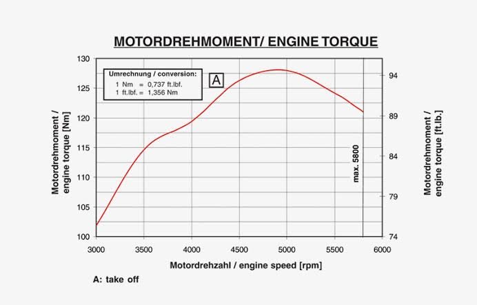

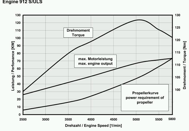

RFguy Posted June 13, 2021 Author Posted June 13, 2021 (edited) Stuart, which book was that from ? this curve from the tech manual ( I have) looks different. 912ULS torque (attached below) Edited June 13, 2021 by RFguy
