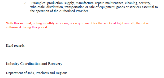

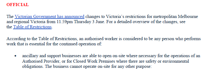

djpacro Posted September 18, 2021 Posted September 18, 2021 Aviation businesses are permitted to fly aircraft per maintenance requirements. The alternative is to inhibit the engines.

aro Posted September 18, 2021 Posted September 18, 2021 On 18/09/2021 at 2:51 AM, djpacro said: Aviation businesses are permitted to fly aircraft per maintenance requirements. Expand "Monthly servicing is a requirement for the safety of light aircraft" Do you have a reference for that? I know many aircraft that are not serviced monthly. Has someone been telling porkies to the department? In any case it says servicing is authorized, not flying.

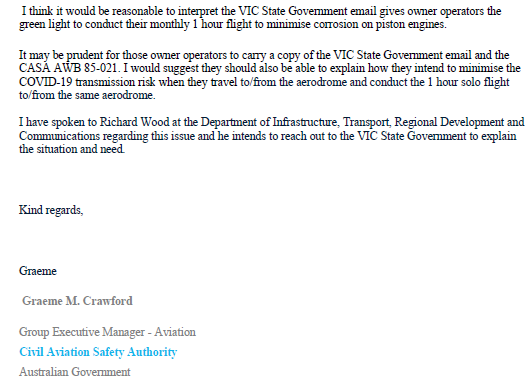

djpacro Posted September 18, 2021 Posted September 18, 2021 Maintenance per CASA https://www.casa.gov.au/files/awb-85-021-issue-1-–-piston-engine-low-utilisation-maintenance-practices and Lycoming https://www.lycoming.com/content/service-letter-no-l180b 1 1
aro Posted September 18, 2021 Posted September 18, 2021 On 18/09/2021 at 5:11 AM, djpacro said: Maintenance per CASA https://www.casa.gov.au/files/awb-85-021-issue-1-–-piston-engine-low-utilisation-maintenance-practices and Lycoming https://www.lycoming.com/content/service-letter-no-l180b Expand Neither ascribe any benefit to flying every 30 days. They recommend preservation if the engine will be inactive for more than 30 days. Flying every 30 days is probably the worst case scenario - often enough to produce water and acid combustion byproducts, not often enough to give the benefit of frequent flying, and the engine is not inhibited.
turboplanner Posted September 18, 2021 Posted September 18, 2021 On 18/09/2021 at 5:11 AM, djpacro said: Maintenance per CASA https://www.casa.gov.au/files/awb-85-021-issue-1-–-piston-engine-low-utilisation-maintenance-practices and Lycoming https://www.lycoming.com/content/service-letter-no-l180b Expand The first letter you posted relates back to Lockdown 4 , was from Dept Jobs, Precincts and Regions and appears to be clarifying the boundaries for an essential worker. The second letter from CASA is undated and is an opinion - this may even come from 2020. The only authority issuing lockdown instructions is DHHS through the Chief Health Officer and the basis for leaving home is very clear. I would agree with Aro, in getting an essential Aircraft Maintenance person to fly the aircraft if that was really necessary.
djpacro Posted September 18, 2021 Posted September 18, 2021 On 18/09/2021 at 5:26 AM, aro said: Neither ascribe any benefit to flying every 30 days. They recommend preservation if the engine will be inactive for more than 30 days. Flying every 30 days is probably the worst case scenario - often enough to produce water and acid combustion byproducts, not often enough to give the benefit of frequent flying, and the engine is not inhibited. Expand "In general, manufacturers recommend that for engines which won’t be flown for 30 days or more, a preservation regime should be instigated." So, one or the other. "The desired flight time for air cooled engines is at least one continuous hour at oil temperatures of 165°F to 200°F at intervals not to exceed 30 days ..." so that is what I do. On 18/09/2021 at 5:26 AM, turboplanner said: The first letter you posted relates back to Lockdown 4 , was from Dept Jobs, Precincts and Regions and appears to be clarifying the boundaries for an essential worker. The second letter from CASA is undated and is an opinion - this may even come from 2020. The only authority issuing lockdown instructions is DHHS through the Chief Health Officer and the basis for leaving home is very clear. I would agree with Aro, in getting an essential Aircraft Maintenance person to fly the aircraft if that was really necessary. Expand Yep, same rules apply now. Closed businesses may undertake essential maintenance. Yep, CASA email is just an opinion. I only have that extract however I understand it is quite recent. 1

aro Posted September 18, 2021 Posted September 18, 2021 On 18/09/2021 at 5:40 AM, djpacro said: "In general, manufacturers recommend that for engines which won’t be flown for 30 days or more, a preservation regime should be instigated." So, one or the other. Expand No. It only means that preserving is considered too much trouble for less then 30 days, not that flying every 30 days avoids the problems prevented by preserving. On 18/09/2021 at 5:40 AM, djpacro said: "The desired flight time for air cooled engines is at least one continuous hour at oil temperatures of 165°F to 200°F at intervals not to exceed 30 days ..." so that is what I do. Expand That is under the heading "ACTIVE ENGINES". Your logic is circular. It's only ACTIVE because you flew it instead of preserving it. If you're worried about your engine in lockdown, preserve it. That work is clearly on the authorised list.
