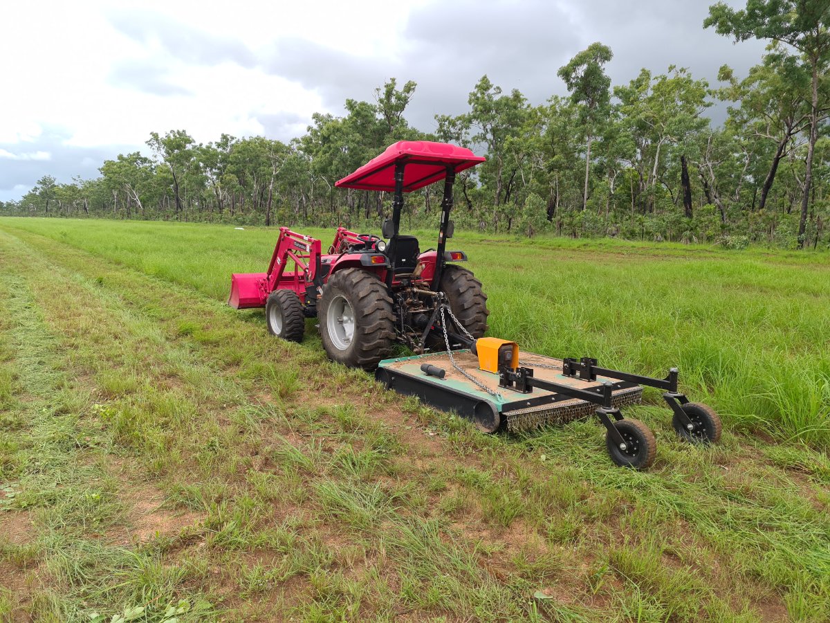

NT5224 Posted November 2, 2021 Posted November 2, 2021 Hi Jackc I went exactly through the process you describe about three years ago when I established Robin Falls International. I had to clear thick woodlands to get my strip in, but the native grasses grew back thick as soon as the first rains fell. As soon as you remove the canopy the natives want to shoot up.... No idea want your patch is like but why not hang off for a few months to see what pops up? Slashing natives makes them look a lot like grass, and its the best permanent solution to avoid erosion. Introduced grasses might not survive. Cheers Alan 6 1
NT5224 Posted November 2, 2021 Posted November 2, 2021 (edited) Oh, and the roos love it, so if you're a 'bunny farmer' like me you might need to chase em away before landing...🤣 Cheers Alan Edited November 2, 2021 by NT5224 1
