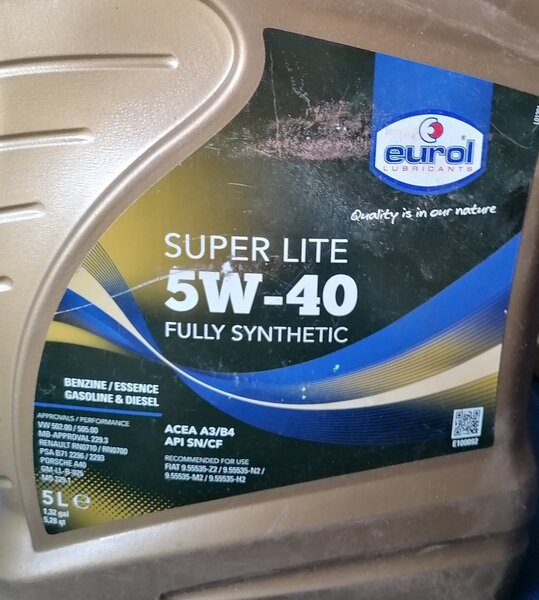

Wee wee Posted November 22, 2021 Posted November 22, 2021 Hi everyone, Would you put this oil in a rotax 912 uls?
IBob Posted November 22, 2021 Posted November 22, 2021 (edited) Why not just use Aeroshell Sport Plus 4 as Rotax recommends? Here is a list of recommended oils: https://legacy.rotaxowner.com/si_tb_info/serviceinfo/si-912-016.pdf Edited November 22, 2021 by IBob 2
Wee wee Posted November 22, 2021 Author Posted November 22, 2021 Thanks Ibob for the reply, My company is using this oil to save some money.... But it feels very cheap so I wanted to make sure.
Blueadventures Posted November 22, 2021 Posted November 22, 2021 (edited) 47 minutes ago, Wee wee said: Thanks Ibob for the reply, My company is using this oil to save some money.... But it feels very cheap so I wanted to make sure. Its not the engine so much as the gearbox clutch setup that needs a specific oil type. I would never use anything other than the Areoshell Sport Plus 4, don't worry about the extra cost. Clutch longevity is what I want. Edited November 22, 2021 by Blueadventures 4 2 1

IBob Posted November 23, 2021 Posted November 23, 2021 I have also read that manufacturers may change their oil formulations without notice, but that Shell have agreed to consult with Rotax before doing that with Aeroshell Sport Plus 4. It seems to me that cost of oil is a very small part of the cost of operating a 912. Given that we depend on the engine to keep us in the air, I don't know why anyone would consider moving away from the Rotax recommended oils, unless for some reason they are unobtainable. 1 2 1

skippydiesel Posted November 23, 2021 Posted November 23, 2021 No matter the oil used (within reason) the engine is very very unlikely to stop (in flight failure) due to the oil used. The quality/formulation of the oil impacts on engine longevity ie use the wrong oil and the expected operational life of the engine is likely to be reduced - this may counteract the short term financial savings referred to by Wee wee. Shell Sport Plus 4 is expensive but a 912 uses only three litres per oil change, every 100 hrs (if using ULP) - personally I like to change the oil every 50 hrs but that is to satisfy my own emotional need.
