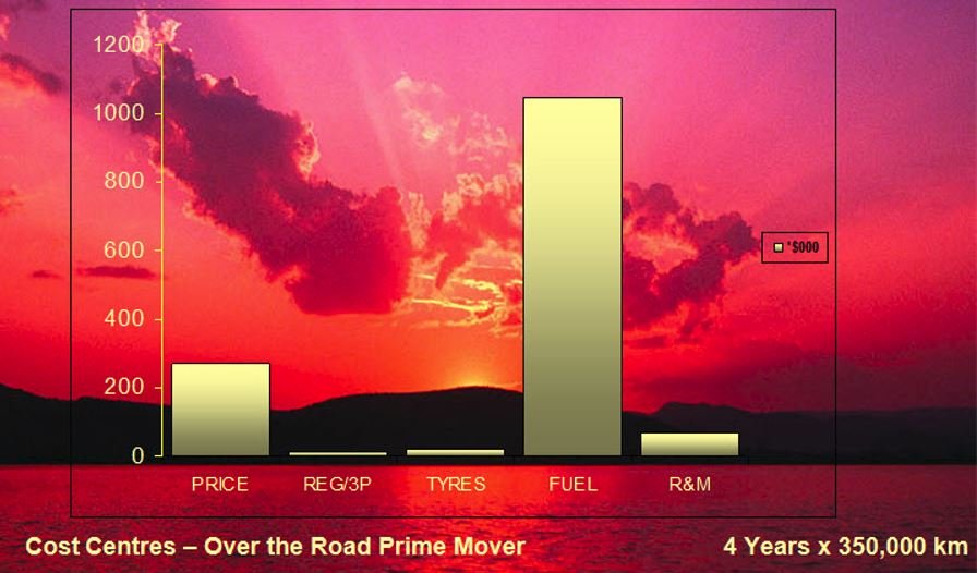

Future Fuels – Hydrogen
CO2 is not measured on Australian vehicles because exhaust emission of CO2 is dependent on the standard of the fuel and diesel is under threat because it is part refined and relatively dirty.
However, CO2 and Global warming are not the only reason we should be looking for alternative fuel. Since 1979 fuel costs have risen way beyond the CPI to the point where long distance travel for holidays is less affordable than it was in the 70s. This in turn has lowered the income of many country towns which in the 70s had thriving tourism facilities.
So cost reduction is right up near the top of the list of reasons for finding a different fuel.
Some fuels which may produce less CO2 will be knocked out by this factor.
Car Manufacturers have handled the cost increase by selling excitement and allowing more applications in SUV and these are now market leaders, while non-towing cars have become lighter, retained low initial costs and are starting to achieve highway fuel consumption of around 4 litres/100 km.
The truck industry has been able to take another path by increasing the volume of freight carried be changing maximum length and height dimensions and reducing fuel consumption.
A B Double today with one driver and one Prime Mover carries as much volume as three semi trailers of the 1970s, and this has allowed companies to survive in applications where Prime Movers consume massive amounts of fuel per year.
When we look at future fuels we have to match them to the applications people want to operate in.
Hence, EV so far is not much use to the No1 sector of the car market because of towing power demand and long distances at high speed, and with trucks required to keep within maximum dimension and weight limits, so aside from the proposed fuel working or not working in an engine there are the practical limits which must be met for long term success.
The attached story from the Age yesterday is about the first Hydrogen Supply Station in Australia which is being built at Truganina in Melbourne. This is for Hydrogen Gas to be burnt by an ICE engine (as against a hydrogen fuel cell vehicle with electric wheel motors). Some people have said Hydrogen will make EVs obsolete.
Truganina is an industrial zone west of Melbourne and an ideal B Double departure point for Sydney, Brisbane, Adelaide, Darwin and Perth.
My job is to design trucks which can be ordered, delivered within about six weeks and go straight into service for their lifetime which is about 3 million km, so I was casually looking at what would be required for a hydrogen truck (leaving the engine to be designed and built by engine manufacturers).
The current extremes with diesel fuel for a Prime Mover are customers who believe their business is carrying freight, not fuel so buy their fuel enroute and set a maximum fuel tank capacity at 800 litres. Offsetting them are customers who believe they get ripped off by service stations so do a bulk deal with an oil company and carry enough fuel for the trip. They require a minimum 2500 litres. If you thought W&B was hard with an aircraft try getting these extremes within the wheelbase and meeting maximum axle loadings. The 2500 litres required square aluminium tanks which produce maximum volume per metre of length, jamming the front tank within about 50 mm of the steer tyre and the rear tank about the same to the drive tyre, the outer face at the legal truck width limit and the inner face allowing a tiny space for the prop shaft.
So can hydrogen fit into this? Well we don’t know, because the fuel vessel has to be decided. LNG trucks required a heavy steel tank with fuel at 2000 psi; will hydrogen require a similar heavy tank. What will be the fuel consumption of hydrogen compared to diesel? Well we don’t know that yet.
What we do know is that with only one refuelling point, the first trucks at least will have to carry enough hydrogen to make the round trip Melbourne-Brisbane-Melbourne etc, or limit their operations until other supply stations can be built, and these look like very expensive stations, not just stations with holding tanks like petrol and diesel with a tanker delivering the product.
Unless the engine burns a lot less hydrogen than diesel on the same task or unless we can carry the fuel at low pressure within about a t6 mm skin, then we are not going to be able to enter the market with these trucks until there are hydrogen supply stations within our range, because we have no legal space.
Before the customer makes a hydrogen commitment, he’s going to be looking at the cost of hydrogen and the consumption per kilometre. Take a look at the attached graph and you can see why – his fuel bill for diesel exceeds the cost of the Prime Mover in about 12 months, and he’s paying more than a million dollars every four years!
If we look at hydrogen for aircraft, the size and weight of the fuel tank will also be a critical factor in deciding whether to switch.
