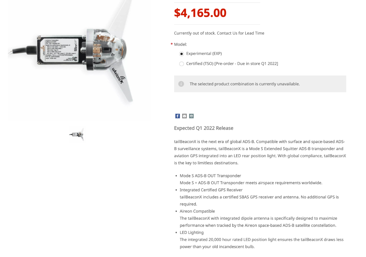

Kyle Communications Posted December 20, 2021 Posted December 20, 2021 I would get one of these https://www.uavionix.com.au/tailbeaconx/ 1

kgwilson Posted December 20, 2021 Posted December 20, 2021 I've done no research but the Uavionix Tailbeacon seems like a good option covering everything but I have no idea how it connects to what on your panel. Flight following is only useful to me over long water crossings & those I am no longer doing. When I am going anywhere my Spot tracker keeps my family informed so I don't give a rats about transponder codes. 99% is in uncontrolled airspace so I am just interested in what else is around in a 50NM radius & that they can see me as well. If I can get that tech for just $450.00 without any fancy installation, that is all I need. It connects to a number of free Aviation apps I can install on my tablet & phone as well. 1
Thruster88 Posted December 20, 2021 Posted December 20, 2021 Just for education I think the tailbeacon is ADS-B out only. The IN bit is what we pilots need in our aircraft for traffic awareness.

Thruster88 Posted December 20, 2021 Posted December 20, 2021 On 20/12/2021 at 5:34 AM, Kyle Communications said: I would get one of these https://www.uavionix.com.au/tailbeaconx/ Expand This seems cheap until you add a control head $1500, cables plus installation. The online prices for transponders is never a complete system price. Transponder, encoder, gps source, cables, antennas plus installation is all required. A simple all in one panel mounted box would be nice for simple aircraft. 1

Kyle Communications Posted December 20, 2021 Posted December 20, 2021 Thruster...I have a MGL EFIS..it directly connects to it...I dont need the head 1
Kyle Communications Posted December 20, 2021 Posted December 20, 2021 Well if CASA or the gubberment fella is going to front up a lot of the cost then get the best you can. The Tailbeacon also has Aerion the satellite based ADSB one as well as terrestrial and throw in a flashy bright light in the back for some bling....shit you have won me over Oh by the way I do have a SE2 1
