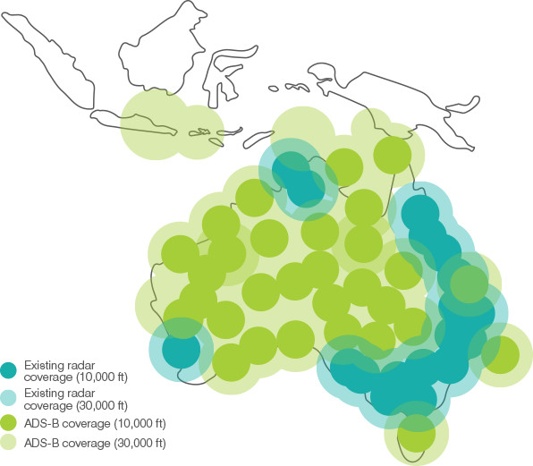

  On 21/12/2021 at 5:04 PM, turboplanner said:
I was talking about Radar, not ADS-B coverage
Expand
I know that. And if you honestly believe ASA has nation-wide radar coverage, I have this beaut bridge with a great view of the Opera House I'll sell you cheap.
Here is the CASA ADS-B coverage map during the rollout of ADS-B in Australia, circa 2017. Green is ADS-B, blue is SSR. Get outside the J-Curve, Perth or the Tindal/Darwin area and there is no coverage! Which is why ASA+CASA mandated ADS-B in the NW region of WA years before the rest of the country - because they have heavy jets flying into multiple airports only 30NM apart, which absolutely zero visibility of where they are in relation to a potential conflict...
This kind of coverage is precisely why ADS-B is great for those of us that fly beyond radar coverage. Not only does it show other aircraft where you are - but your missus or kids can track you to your destination using FA/FR24.

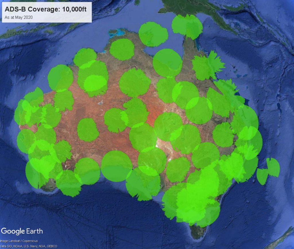

And ADSB coverage is a lot better now.  This is last year at 10K
https://www.airservicesaustralia.com/about-us/projects/ads-b/ads-b-coverage/
