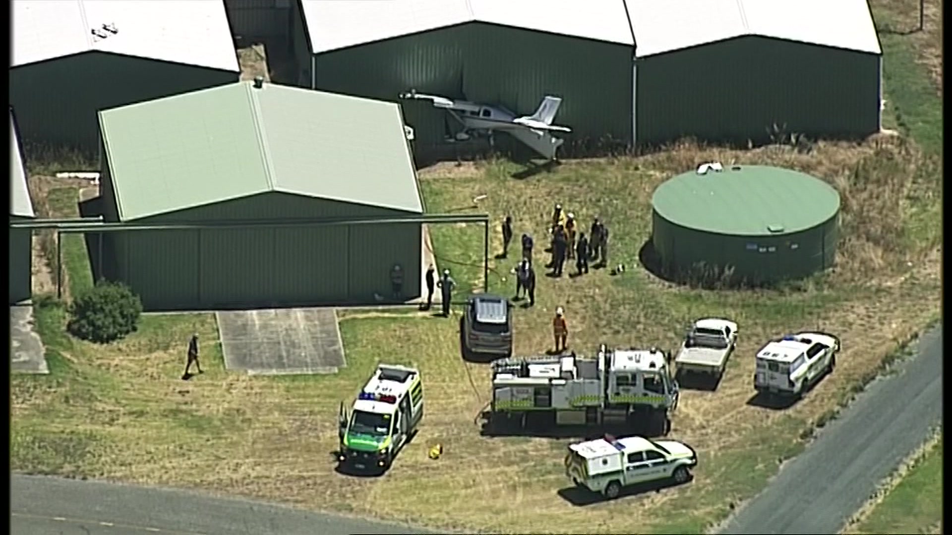

KRviator Posted December 30, 2021 Posted December 30, 2021 Just to prove it isn't always engine failure that can kill a Jabiru, one speared off the runway and into a hangar at Goolwa today while landing. 2POB enroute to the hospital with moderate injuries. I'm actually fairly impressed he's managed to get it between that other door outrigger &the water tank though! Images courtesy of the ABC... 2 1
onetrack Posted December 30, 2021 Posted December 30, 2021 (edited) How the dickens did he do that? The wind was reportedly 6-9kts from the SE at the time, turning Southerly and lighter now. Did he get hit by a wind gust? Those buildings are at the end of the runway! He went a lo-o-ong way off the runway, to do that! Also, the airport cam didn't pick up his excursion, or even his landing? https://www.windy.com/-Outdoor-map-map?map,-35.475,138.747,18 Edited December 30, 2021 by onetrack
turboplanner Posted December 30, 2021 Posted December 30, 2021 16 minutes ago, onetrack said: How the dickens did he do that? The wind was reportedly 6-9kts from the SE at the time, turning Southerly and lighter now. Did he get hit by a wind gust? Those buildings are at the end of the runway! He went a lo-o-ong way off the runway, to do that! Also, the airport cam didn't pick up his excursion, or even his landing? https://www.windy.com/-Outdoor-map-map?map,-35.475,138.747,18 A LOT of Jabs reported in the RAA accidents section of the magazine land nose down and wheelbarrow in a semi circle off the runway with about a quarter of them finishing up resting on nose or wing, or upside down. This accident may have had nothing to do with that, but that manouvre is close to No1 in the RAA Magazine. 2 2

440032 Posted December 30, 2021 Posted December 30, 2021 Is that the port aileron on the water tank? 1 1
