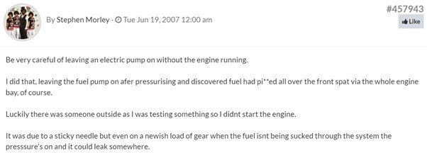

turboplanner Posted January 9, 2022 Posted January 9, 2022 9 hours ago, aro said: Unlikely. If there is a leak in the fuel line before the engine driven pump in a low wing aircraft, it will suck air and the engine will lose power/stop. At which point the first action is turn the pump on... If there is a leak after the engine driven pump e.g. carb float valve, it probably doesn't make much difference if the aux pump is on or not because the engine driven pump is supplying fuel pressure. Leaks after the engine pump are the problem; attached below is a first hand example of one: 9 hours ago, aro said: You quoted the actual reason from the POH in your post. I was going to take the Warrior POH attachment out in case it confused people, but it had a lot of good detail. It gives a succinct reason but there are tnousands of different aircraft fuel pump systems. 9 hours ago, aro said: What they are taught isn't always correct - it seems like there are as many myths in GA as any other level of aviation. Better than someone leaving it turned on for the duration of the fight, or leaving it turned off; and not getting the safety benefits.
