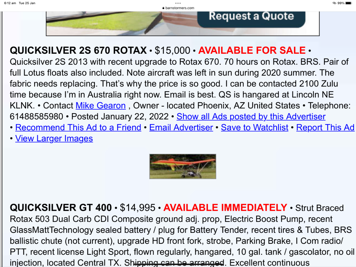

It’s making me want to keep the Quicksilver I have in Lincoln, Nebraska. KLNK. I’ve just stuck it up on Barnstormers at a bargain price.  I’d actually thought about exactly what you’ve done. Take off from the ramp or taxiway. Lincoln Clearance, Lincoln Ground then ground and tower is often the same controller. Just ask if I can go!
I will be back there June. Maybe we can catch up! Especially if I keep the QS. Reality is at Lincoln I’d have to get permission to fly it out of there just the once then would need to keep at non towered airport. We will see.
