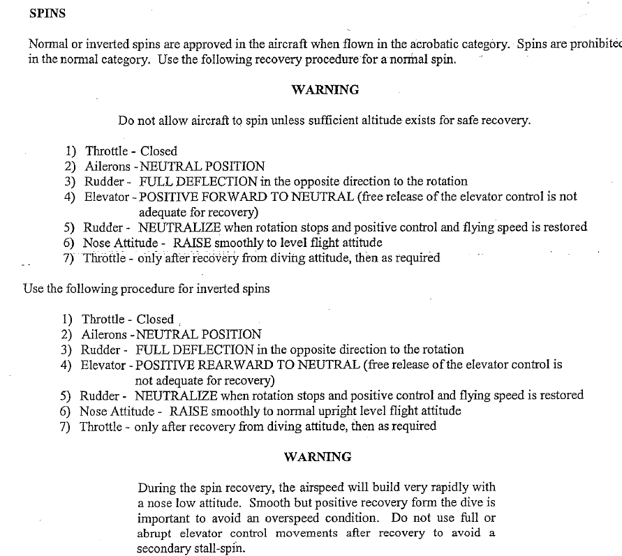

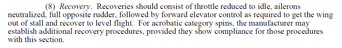

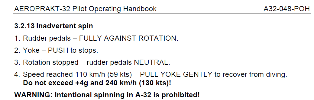

djpacro Posted February 27, 2022 Posted February 27, 2022 7 hours ago, Garfly said: Would you elaborate on that djp? Compare the guidance from the FAA when certifying new aircraft per FAR 23, the Super Decathlon in which I teach spins and the Vixen. An inadvertent spin in a Vixen requires correct actions per its manual promptly rather than attempting a different method as one may have learnt in a Super Decathlon. If the manual states full forward yoke then don't expect halfway to be effective. 1 2
djpacro Posted February 27, 2022 Posted February 27, 2022 I should’ve added: if you use the Vixen method in the Super Decathlon and it will not recover but instead transition to an inverted spin. 1 1
