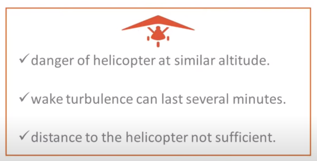

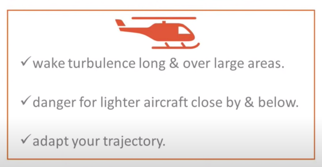

Below is the French (BEA) video (in English) that was referred to by Juan Browne in the video above.
The presenter makes the point that whilst the danger of chopper downwash near the ground is well understood by most pilots
the hazards of rotor wake at large distances and long periods (greater than comparable fixed wing craft) is not well understood.
The video's take away message for chopper and ultra-light pilots respectively is:
image.thumb.png.275c077fa9c42c3c77d4f942e8bfabac.pngimage.thumb.png.c58dd4ba9adc09b743b712c5a757d809.png

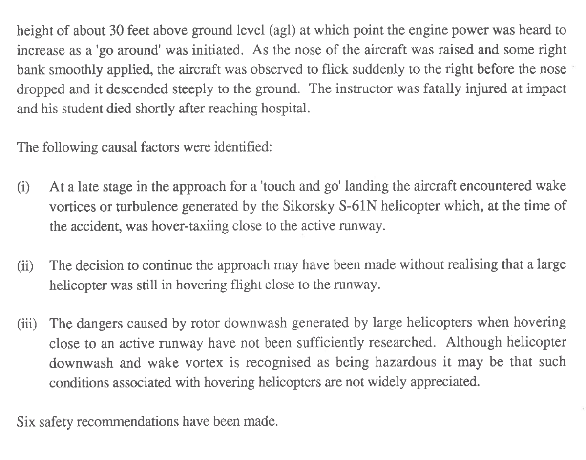

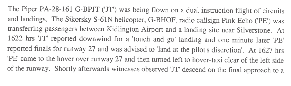

Anyway, for me it means being way more wary of chopper wake and downwash than I was before.
All the more after finding this AAIB (UK) report of a Cherokee getting spun in by a Sikorsky's vortices.
https://assets.publishing.service.gov.uk/media/5422f94de5274a13140006ed/1-1993_G-BPJT.pdf
Excerpt (click image for higher rez):
1-1993_G-BPJT.pdf
