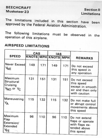

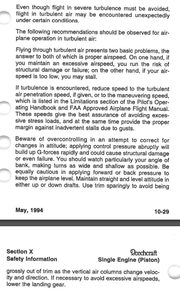

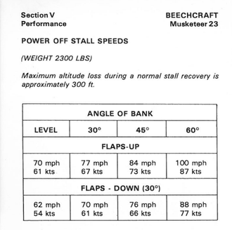

RFguy Posted September 2, 2022 Posted September 2, 2022 (edited) SEE POH INSTRUCTIONS FOR TURBULENT WEATHER BELOW IN POH : Beech 23 normal category 2300 lbs max weight . min weight 1400 lbs Va : 132 MPH 115 knots Vno 151 MPH 131 knots . Vs (clean stall) 70 MPH (clean) . (abouT 61 kts). few assumption in their about quoted weighrs etc (Musk empty 1400, full 2300lbs ) ,based on the muls, i'd say the Muskateer Va is for about half way between max and min weight. airplane SN M529 Edited September 2, 2022 by RFguy
RFguy Posted September 2, 2022 Posted September 2, 2022 (edited) The funny thing is, a Muskateer wont even fly S&L at Va (115 kts) , it would only do it in a vertical dive 🙂 But, seriously, makes it a very forgiving, potentially safe aircraft. cant get in trouble. Most RAAUS aircraft are going to have similar Va to the Jabiru 230- related directly to stall. and RAAUS aircraft generally have wildy varying weights from empty to full. The J230, a speed machine, cruise at 115-118 kts, you are still going to have to slow down to mid 80s (or slower) like every other RAAUS plane that has also low stall speeds. you almost want to be able to reflex the ailerons and flaps to get Vstall up. Edited September 2, 2022 by RFguy
