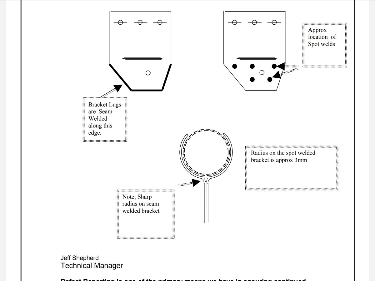

facthunter Posted October 16, 2022 Share Posted October 16, 2022 There's a sheet stainless bit that should be looked at where the wing strut attaches. nev 1 Link to comment Share on other sites More sharing options...
Thruster88 Posted October 16, 2022 Share Posted October 16, 2022 Yes the airworthiness directives or what ever they are called for the thruster are available on the RAAus website. 1 Link to comment Share on other sites More sharing options...
Damien Posted October 16, 2022 Author Share Posted October 16, 2022 Is this the plate facthunter ? Link to comment Share on other sites More sharing options...
Thruster88 Posted October 16, 2022 Share Posted October 16, 2022 46 minutes ago, Damien said: Is this the plate facthunter ? That is the serial number, built in 1988 number 302 in total, mine is 088-286. Facthunter was talking about the strut fittings, they must be spot welded together, not welded along the edges. 1 1 Link to comment Share on other sites More sharing options...
facthunter Posted October 16, 2022 Share Posted October 16, 2022 It's a very structural part, essential to be right. Nev 1 1 1 Link to comment Share on other sites More sharing options...
Damien Posted October 16, 2022 Author Share Posted October 16, 2022 Is this the leading edge and tail edge strut contact points mid wing? thanks guys Link to comment Share on other sites More sharing options...
Thruster88 Posted October 16, 2022 Share Posted October 16, 2022 5 hours ago, Damien said: Is this the leading edge and tail edge strut contact points mid wing? thanks guys Yes the stainless steel part that joins the wing strut and the wing lift wires to the wing front and rear spar. They would almost certainly have been replaced if wrong type however never assume anything with aircraft. Link to comment Share on other sites More sharing options...
