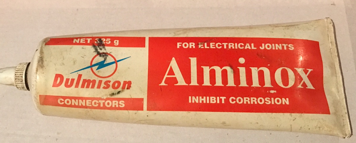

onetrack Posted October 19, 2022 Posted October 19, 2022 Jack, tell us more about this Aluminox product, I can find little on the 'net about it, is it a paint or coating process? The name seems to be used for a lot of unrelated areas.

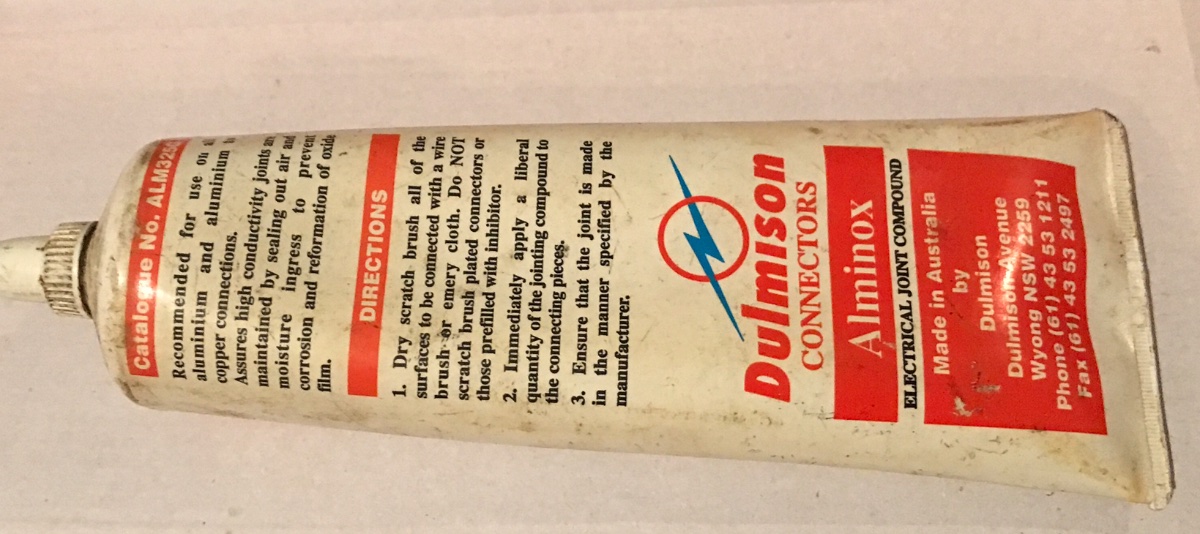

jackc Posted October 20, 2022 Posted October 20, 2022 16 minutes ago, onetrack said: Jack, tell us more about this Aluminox product, I can find little on the 'net about it, is it a paint or coating process? The name seems to be used for a lot of unrelated areas. Sorry, a product misspelling on my part, been using this stuff on Ham Radio antennas for years…. 1 1
Kyle Communications Posted October 20, 2022 Posted October 20, 2022 Aluminox also was used by the power distribution companies when connecting alu clamps to the copper overhead mains and visa versa..that when I first came across it then used it exclusively in my radio busiess for all antenna assembly...fantastic product..hard to get now though but seach for aluminium jointing compound 1 1
onetrack Posted October 20, 2022 Posted October 20, 2022 It's still readily available - Utilux P/No UTIH2397/1. https://www.repelec.com.au/grease-joint-compound-4c-aluminium-250gm-tube.html https://www.rexel.com.au/are/category/Hardware/Cable-Resin/Jointing-compound/UTI-350-GRAM-JOINT-COMPOUND/UTIH2397-1/p/10284056?showBackLink=false And so is Alminox ... https://www.rexel.com.au/are/category/Hardware/Cable-Resin/Jointing-compound/SEALING-COMPOUND-ELECTRICAL-JOINT-ALMINO/DULDULALM325G/p/10279276 1
Kyle Communications Posted October 20, 2022 Posted October 20, 2022 Thanks Onetrack... I havent chased it as I still have a heap of it from back in the old days :)..my stuff is probably more than 25 years old and still perfect. It should be in everyones workshop 🙂 1
