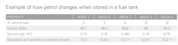

kgwilson Posted November 24, 2022 Posted November 24, 2022 (edited) All of the things mentioned were included in the BP study of 2010 which I have posted on this site a couple of times. One thing your bloke did not say is that aged fuel (over 5 weeks old in a vehicle or appliance tank) causes the mixture to be lean and the engine overheats resulting in detonation and piston damage in High Revving engines such as those found in chainsaws and boat engines. I can attest to this after one of the SES chainsaws would not start after being used once after sitting idle for 6 months. The report from the Stihl shop was "hole in piston, scored bore and big end damage" & the saw was trashed. This is not a major issue with a low compression low revving aircraft engine. I have started & run my J 3300A engine after well over 5 weeks without adding fuel & it started first turn of the key & ran well. This is not my normal procedure. That is to add fresh fuel every time I have 30 litres or less in the tank. BP recommended a bit of fresh be used if the fuel has been in the tank for over a week. You do not need much but you will need more the longer the fuel has been in the tank. I keep our 8 SES emergency generators with very little fuel in them and always put 3-500 ml in the tank before going through the monthly generator test process. They are then run under load for 10-20 minutes. The comments re plastic containers is very valid. I have a 4 litre ex oil container for lawn mower petrol. The light components permeate the plastic and the container stinks of fuel. The same is true for the vinyl ester tank in my aircraft fuselage. It dissipates quickly when I open the canopy after it has been in the hangar for a week. The heavy wall plastic containers are much better. The pdf of the BP study is attached. petrol-life-vehicle-tanks.pdf Edited November 24, 2022 by kgwilson 2

RFguy Posted November 24, 2022 Author Posted November 24, 2022 (edited) Hi KG I cant see the evidence that 'stale fuel' causes the mixture to be lean anywhere. according to this BP publication, the usage actually riches up.... https://www.bp.com/content/dam/bp/country-sites/en_au/australia/home/products-services/fuels/opal-factsheet-storagehandling.pdf see the air fuel ratio reducing (getting richer) Edited November 24, 2022 by RFguy
kgwilson Posted November 24, 2022 Posted November 24, 2022 9 minutes ago, RFguy said: Hi KG I cant see the evidence that 'stale fuel' causes the mixture to be lean anywhere. according to this BP publication, the usage actually riches up.... https://www.bp.com/content/dam/bp/country-sites/en_au/australia/home/products-services/fuels/opal-factsheet-storagehandling.pdf see the air fuel ratio reducing (getting richer) Read the pdf of the BP report " Loss of light components - impact on mixture" section.
RFguy Posted November 24, 2022 Author Posted November 24, 2022 (edited) Hi KG. I think you've interpreted that document incorrectly. mostly it seems to be orientated to engines cold starting and high revving.... They are talking about issues with vaporization at cold temperatures causing lean mixtures at cold startup (like a chainsaw etc revving to life at high revs and suffering pre-ig and detonation) it talks about the mixture going RICH : "Because the fuel carburetors and injectors operate on a volume metering system the higher density means that more fuel is introduced for a given volume of air and so the air fuel ratio is fuel rich. " This does not cause LEAN mixtures in moderately running warm engines. So, stale fuel does NOT cause lean mixtures under normal vaporization (engine warm) conditions. The reduced vapour pressure (stale fuel losing its volatiles) might cause difficulties in getting the correct mixture if the carb is unable to vaporize the mixture tdue to a very cold carby body. In fact the vapour pressure of AVGAS is about~ 40 to 50 kPa versus 60-80 for ULP... and we dont have vapourization problems with AVGAS. Edited November 24, 2022 by RFguy

kgwilson Posted November 24, 2022 Posted November 24, 2022 26 minutes ago, RFguy said: They are talking about issues with vaporization at cold temperatures causing lean mixtures at cold startup (like a chainsaw etc revving to life at high revs and suffering pre-ig and detonation) it talks about the mixture going RICH : "Because the fuel carburetors and injectors operate on a volume metering system the higher density means that more fuel is introduced for a given volume of air and so the air fuel ratio is fuel rich. " This does not cause LEAN mixtures in moderately running warm engines. So, stale fuel does NOT cause lean mixtures under normal vaporization (engine warm) conditions. The reduced vapour pressure (stale fuel losing its volatiles) might cause difficulties in getting the correct mixture if the carb is unable to vaporize the mixture tdue to a very cold carby body. In fact the vapour pressure of AVGAS is about~ 40 to 50 kPa versus 60-80 for ULP... and we dont have vapourization problems with AVGAS. Correct but it is when the engine is cold that the damage occurs. This is also when the most wear occurs in all engines. Engines with large tolerances won't be affected as much but modern engines have far smaller clearance tolerances as enabled by technology and better lubricants. Old sloppy 2 strokes will not be too bothered about lean fuel at cold start. They will just take longer to develop full power so they have time to warm up. With a chainsaw, most users start it with choke, once running, choke off, rev it to full power and start cutting. The bloke at the Stihl shop said they get a spate of failures usually in Autumn when people decide to get in Winter firewood and the chainsaw hasn't been used for 6 months to a year.
