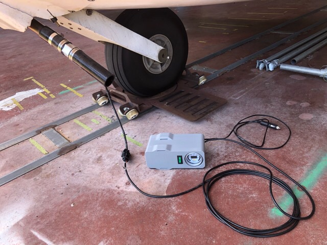

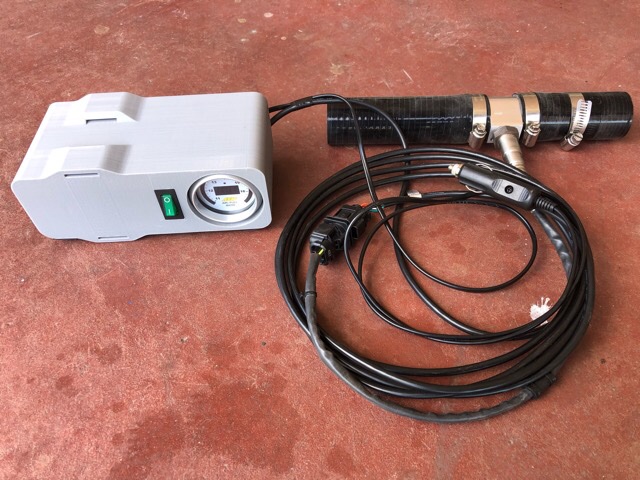

Made up a FART box and tried it out last week; bloody great bit of kit; worth every penny 👍
