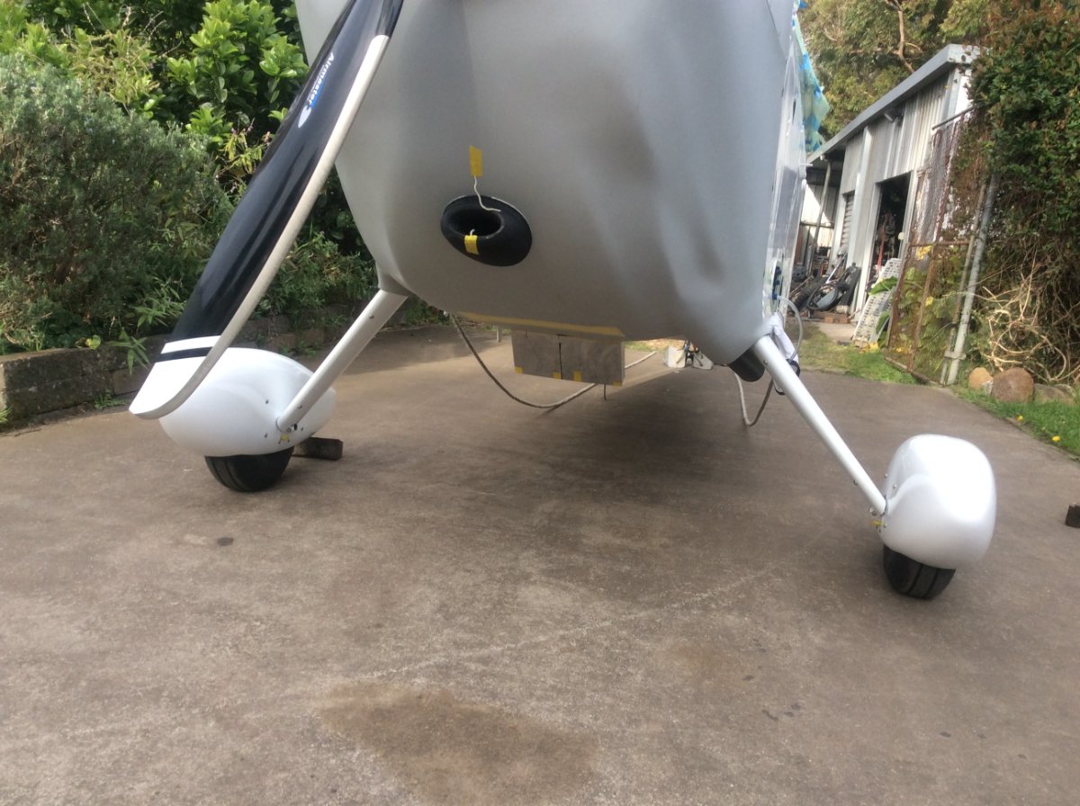

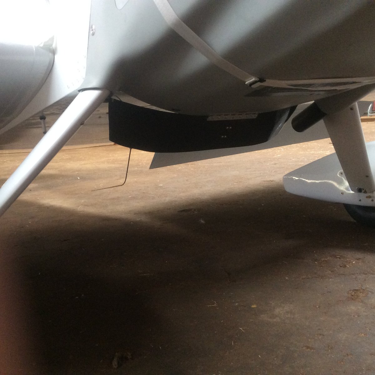

skippydiesel Posted November 29, 2022 Posted November 29, 2022 (edited) Custom cowling - have not painted it yet (work in progress) but think the last modification - installation of cowl flap - has probably brought the ground operating temperatures under control. Thermostatic controlled fan kicks in at 95C & out at 85C Current max coolant temperature (taxying after fast ground run), 105C (was going over 120c) - which is OK. The thermo fan should never operate while aircraft in the air only during ground ops. Edited November 29, 2022 by skippydiesel 1
RFguy Posted November 29, 2022 Posted November 29, 2022 105C and 20 deg ambient ?. hmmm might be hot on a hot day. but all planes have similar issues. 1
facthunter Posted November 29, 2022 Posted November 29, 2022 Usually not on planes with cowl gills operated properly It's a bit much to expect a plane engine to be happy at the wide variety of conditions it encounters without some significant adjustment being available. Nev 1 1

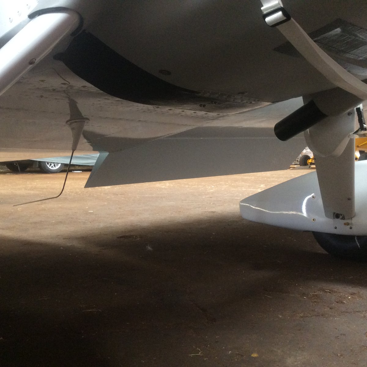

Bruce Tuncks Posted November 30, 2022 Posted November 30, 2022 I like the idea of a cowl-flap skippy. I hope it works and we get to see a diagram of what you did.
skippydiesel Posted November 30, 2022 Posted November 30, 2022 1 hour ago, Bruce Tuncks said: I like the idea of a cowl-flap skippy. I hope it works and we get to see a diagram of what you did. This is the prototype (fixed) cowl flap and the addition of an oil cooler snout - this set up brought temps right down: You can just see the latest , retractable, cowl flap in this shot - will have to take a better view and sent in the next day or so. 4
skippydiesel Posted December 1, 2022 Posted December 1, 2022 Better pis of cowl flap - painting will be done after successful test flying. 2
