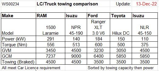

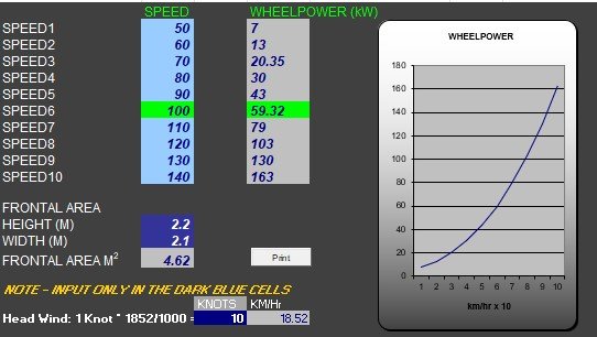

turboplanner Posted December 12, 2022 Posted December 12, 2022 On 12/12/2022 at 8:39 AM, jackc said: Most people try to stay under the 4.5T GVM with small diesel dual wheel trucks. They don’t need to ‘pose’ but just get the job done 🙂 Expand It all starts with the Application. We're trying to get someone 600,00 - 700,000 km total life. All vehicles on the chart meet the 4500 kg GVM Car Licence requirement. Local Tradie's vehicle in the Urban area (below 80 km/hr) The application may not require towing or 100 km/hr highway cruise, so the two columns on the right are going to be able to handle that application. Up to 3500 kg towing with low frontal area (not caravan type bodies) We would be looking at the three columns on the right, and the Ford would do limited 100 km/hr at full GCM with caravan type body. Up to 4500 kg Trailer - Urban area up to 80 km/hr The Isuzu model is a downrated 6500 kg GVM truck so will carry heavy loads and has a GCM of 9000 kg on driver's licence Up to 4500 kg Trailer - Highway 100 km/hr The Ram has twice the power of the Isuzu to push the wind out of the way. Pushing the wind out of the way: The Chart on the left is for a ute/truck with tray body and low load At 80 km/hr, Airpower demand is 40 kW, so not very significant At 100 km/hr, it is 59 kW, still not a huge factor The Chart o the right is for a Caravan/5th Wheeler/Van Body At 80 km/hr even with the bigger body, Airpower demand is only 53 kW At 100 km/hr it's exponentially more at 103 kW On top of this, there is power demand for driveline resistance, rolling resistance (affected by the number of wheels), grade resistance and head or tail winds. This is what gets the owners of vehicles into trouble with blown turbos, motors etc. The engine power output can't meet the power demand requirement at the top end of the envelope in some applications where the same vehicle would happily pull a heavy trailer around all day at low speed. 1
jackc Posted December 12, 2022 Posted December 12, 2022 Turbs, thanks for your efforts with the explanation. At my stage in life I guess the complexity of it all has not as much relevance as it may have, earlier in my life. I try to use simple logic these days, 2 months ago I bought a Mahindra 4x2 ute with a tray. for 2 reasons…..it was half the price of a Hilux and it will last until I die and still do the job I want, it goes everywhere my 75 series Landcruiser goes on my steep property as it has an Eaton Auto Rear Diff Locker that actually works! So far 3 people have bought one after looking at mine 🙂 I guess application wise I made a good decision 🙂
