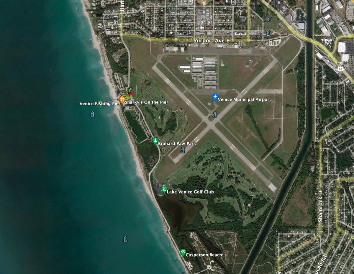

djpacro Posted December 8, 2022 Posted December 8, 2022 Two hours after sunset. https://aviation-safety.net/wikibase/302136 USA PPL includes night VFR training and the permission for night VFR flights. I wonder if the training included taking off over the water with no lights ahead. When I did my night VFR rating we did circuits at Philip Island out over the water on a dark night. https://www.aviationsafetymagazine.com/features/dark-and-deadly-nights/ 1 3
IBob Posted December 8, 2022 Posted December 8, 2022 That article referencing the Australian dark sky takeoff accidents study makes for sobering reading: "Interestingly enough, investigators found that in every case the doomed aircraft struck the ground within 3 nm of the airport, and within one minute of becoming airborne. In 87 percent of the crashes, the aircraft impacted to one side of the extended centerline with wings showing little or no bank at the time of impact. In every crash, the wreckage indicated that the aircraft was under control at the time of impact. Specifically, the investigators noted that the aircraft damage was consistent with the pilot being unaware of any unusual attitude." 1 3
facthunter Posted December 8, 2022 Posted December 8, 2022 With no visible horizon as the plane accelerates the illusion of pitch up occurs and people just nose over. It's a well known phenomenon for IFR Pilots. Nev 1 2

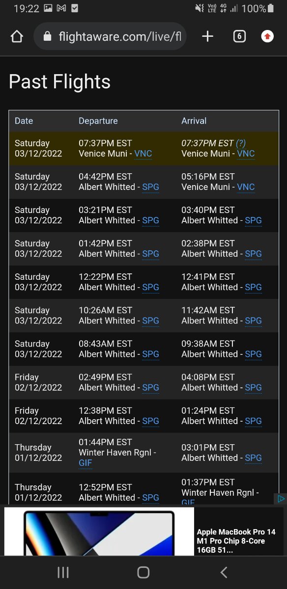

Bosi72 Posted December 11, 2022 Posted December 11, 2022 It appears the Cherokee was well utilised. It was the 7th flight on that day. https://flightaware.com/live/flight/N4676F 1
