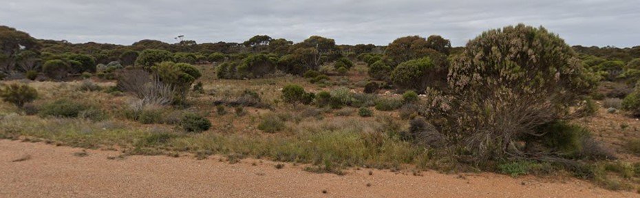

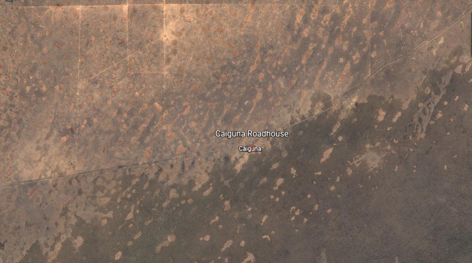

onetrack Posted December 19, 2022 Posted December 19, 2022 (edited) We have not been told which direction the Jabiru SK that crashed took off in. One would presume that he took off to the NE, because that direction provides a far less vegetated area, for a less-eventful forced landing - even though that direction takes the aircraft nearly over the roadhouse, and associated buildings. If he took off to the SW, then that direction contains much more heavy vegetation, including some sizeable mallee trees - which would make a forced landing much less survivable. Regardless, the prevailing wind was almost at 90° to the airstrip, which meant that to turn into the wind, to try and gain altitude, would involve a turn of 90°. But at the end of the day, with all the signs the engine power output was far less than acceptable (lack of altitude gain) - then a turn of any type, with the associated increased power requirement, or loss of airspeed, is the last thing he should have been doing. He could have taken off to the NE - and if the altitude gain was completely unsatisfactory - there's no reason why he could not have made a successful forced landing without turning, into a large area that contains little more than low shrubs. Edited December 19, 2022 by onetrack 1

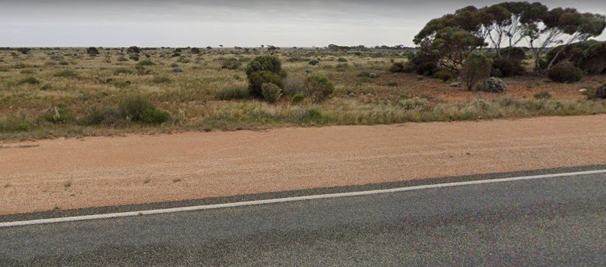

onetrack Posted December 19, 2022 Posted December 19, 2022 I have just discovered that the West Australian newspaper updated its article about the crash, to state that the aircraft "took off in a Westerly direction". This means he departed in a South Westerly direction, and over the heavier type of vegetation in every direction in front of him - thus making any forced landing highly problematic. I fail to understand a lot of the decisions made by this pilot, it seems that nearly every decision he made, was wrong - apart from the initial decision to abandon the ferry flight. 1
turboplanner Posted December 19, 2022 Posted December 19, 2022 (edited) 44 minutes ago, onetrack said: I have just discovered that the West Australian newspaper updated its article about the crash, to state that the aircraft "took off in a Westerly direction". This means he departed in a South Westerly direction, and over the heavier type of vegetation in every direction in front of him - thus making any forced landing highly problematic. I fail to understand a lot of the decisions made by this pilot, it seems that nearly every decision he made, was wrong - apart from the initial decision to abandon the ferry flight. North of Caiguna/strip is open country, south is scrub and dangerous, so I wouldn't be planning any circuits over the scrub. Photo xCaiguna shows the strip and Highway, xOpen is the land north of the highway, xscrub is south of the highway. The definition is not good enough to decide whether the Open area is landable, but it would only be about 30 degrees from the takeoff line. (The strip is in the picture, one of the patches just SW of the roadhouse.) Edited December 19, 2022 by turboplanner
kgwilson Posted December 19, 2022 Posted December 19, 2022 It is a pretty decent strip of 1265 metres according to Mr Google. The best place to land is on the Eyre highway or to the North where there is no scrub. To the South West though there are quite a few clear patches. One is about 3km from the runway and is about 1100 metres long in the same direction as the runway. If you had some height this would be quite possible but without it in this direction your choices are very limited. 1
