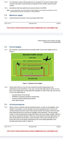

turboplanner Posted December 19, 2022 Posted December 19, 2022 1 minute ago, RFguy said: I learned 500 ' circuits, which are close to the strip with a 15 knots steady pure crosswind on the grass strip with low cloud. the grass strip made those limit crosswind landings a little more forgiving.... With the wind about 25+kts at 500' the drift was impressive and made flying circuits quite a bit of fun. What about the Trikes, Drifters etc inbound for their mandatory 500' circuit? 1
RFguy Posted December 19, 2022 Posted December 19, 2022 (edited) what about them ? sorry I dont understand the question. Edited December 19, 2022 by RFguy 1
BrendAn Posted December 19, 2022 Posted December 19, 2022 12 minutes ago, RFguy said: what about them ? sorry I dont understand the question. I think he means you are flying around in the circuit height reserved for under 55 knots. 1 1
BrendAn Posted December 19, 2022 Posted December 19, 2022 You should have been in a 1000ft circuit. 1
RFguy Posted December 19, 2022 Posted December 19, 2022 (edited) No 30 minutes ago, BrendAn said: You should have been in a 1000ft circuit. Yes, under normal circumstances . These were operational constraints that required it. Wait till you do some circuits with low cloud and intermittant drizzle , your circuits will be something like 700' etc etc ANyway no trike is going to be out in that weather. and no trike should dare come near a busy aerodrome without a radio. Turbs I think your comment is non sensical, without qualification. Edited December 19, 2022 by RFguy 1 1
turboplanner Posted December 19, 2022 Posted December 19, 2022 58 minutes ago, RFguy said: No Yes, under normal circumstances . These were operational constraints that required it. Wait till you do some circuits with low cloud and intermittant drizzle , your circuits will be something like 700' etc etc ANyway no trike is going to be out in that weather. and no trike should dare come near a busy aerodrome without a radio. Turbs I think your comment is non sensical, without qualification. You could kill someone, so I'd suggest rather than comment that something is nonsensical, you study the rules you are supposed to be flying under. Last time I looked and posted them on this site they were clear enough for anyone to avoid inventing a scenario to suit themselves. There is a a procedure for weather which is marginal to the point that a landing is necessary and it is called a Precautionary Landing, and it involves specific jobs to ensure the safety of the people in the aircraft such as zeroing the DG and specific tasks for each circuit, and it is taught and practised away from any airfields. One of the reckless attitudes associated with low volume airfields is the belief that no one else is around. There are plenty of ATSB reports to learn that lesson. 1
Kiwi Posted December 19, 2022 Posted December 19, 2022 2 hours ago, turboplanner said: What about the Trikes, Drifters etc inbound for their mandatory 500' circuit? Not mandatory going by CASA, the wording is "should" 1 1 1

turboplanner Posted December 19, 2022 Posted December 19, 2022 2 hours ago, Kiwi said: Not mandatory going by CASA, the wording is "should" Yes, I shouldn't have gone from memory and used the word "Mandatory". However, the word "should" is defined as "used to indicate obligation, duty or correctness" and you missed out the couple: "By Convention" "By Convention" is defined as "a way of doing something or appearing that is considered usual and correct." These two are coupled together in this context, and both are coupled with a safety procedure. As Kiwi pointed out this is not a prescriptive regulation. So if you're at the wrong level and there's an accident and someone sues you good luck with insurance and a defence against a duty of care breach. 1
