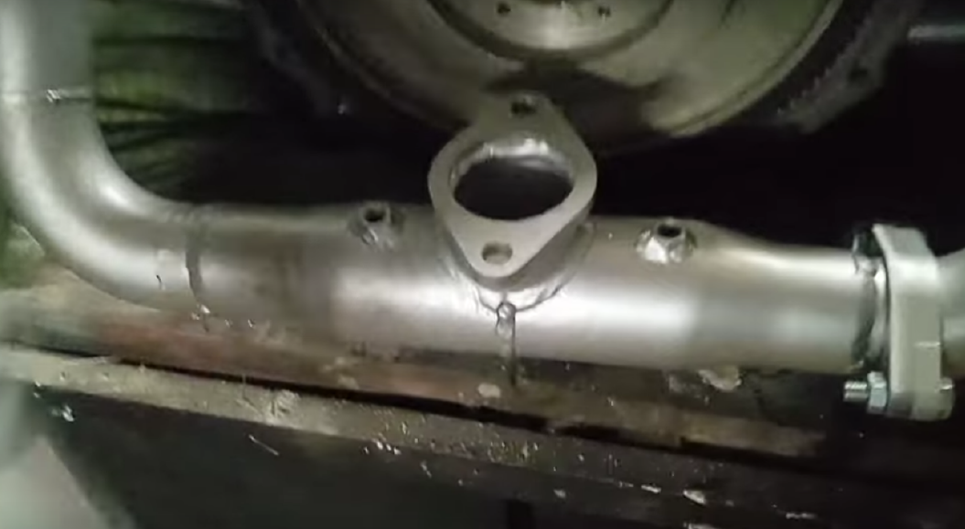

Someone I know in New Zealand has a request:
Volkswagen Induction Manifold Heater Assembly:
I seek help in being able to locate a drawing of an Intake manifold that incorporates an oil feed induction manifold Heater (similar to the one in the Taylor Monoplane Drawings) which also serves as an Oil Cooler – similar to those used in the conversion of Volkswagen Engines by Rogers and Revel for Amateur-Built Aircraft in the 60–80's.
I only have about 3% of an idea what it even is. Sounds like real old technology and anyone likely to have been messing with this stuff might be long gone.
Any thoughts? Thanks.
image.thumb.png.22b64fcdeb7fede98d8667c77e38efc8.pngHere is one done with a tube surrounding the manifold with 2 oil holes piped into oil cooler lines before  cooler
On the cars it  was heated by an exhaust bleed which eventually blocked up and was near impossible to  clean out. There will be a delay in the oil being heated enough but the original problem won't exist. The manifold is too long causing most of the icing problem.  Nev
Yes, VW conversions were notorious for icing, particularly at the lower ‘T’ join where the two sides came together at the rear bottom of the crankcase, as seen in the pic above. A simpler solution is to weld a thick steel tang (not stainless) to that T which bolts to one of the crankcase bolts. This conducts heat from the crankcase to the T.  Oh, and also have a carb heat system.  I flew behind a VW conversion like this for over 700 hours mostly in the southern tablelands of NSW and never once had to pull carb heat despite flying in icing conditions.
 Mark
Thanks GerryC, that's probably the sort of thing he's talking about, there is a specific plan/drawing he is seeking, he knows what he wants.
I fixed the problem by eliminating the inlet manifold. Installed EFI based on Bosch hardware scavenged from an old 1600TS. Same thing can be done using BMW hardware. Mark knows all about my efforts but I would still prefer a 2200 Jab. Kills the VW for low mass and power output. Jabs rarely suffer icing.
