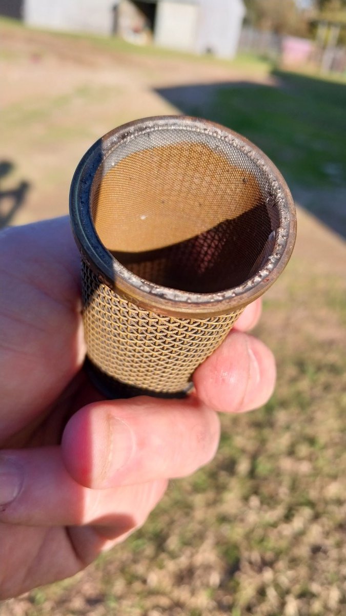

Thruster88 Posted July 4, 2023 Posted July 4, 2023 6 hours ago, facthunter said: Notably, it didn't run an oil filter either. Just a screen. The bearings were ALUTIN not very tolerant of dirt. Nev The o-320 lycoming in my Musketeer only has the brass screen, it is very fine. Much easier to check for metal contamination the the paper filters. It is on track to make TBO. 1
facthunter Posted July 4, 2023 Posted July 4, 2023 (edited) Your Crank is nitrided.. So are SOME lycoming cylinders. Nev Edited July 4, 2023 by facthunter 2
facthunter Posted July 4, 2023 Posted July 4, 2023 The brass screen type is unlikely to ever block up if you do anything like the right thing in the inspection department. A magnet in there would help also, reliably attached. Nev 1
