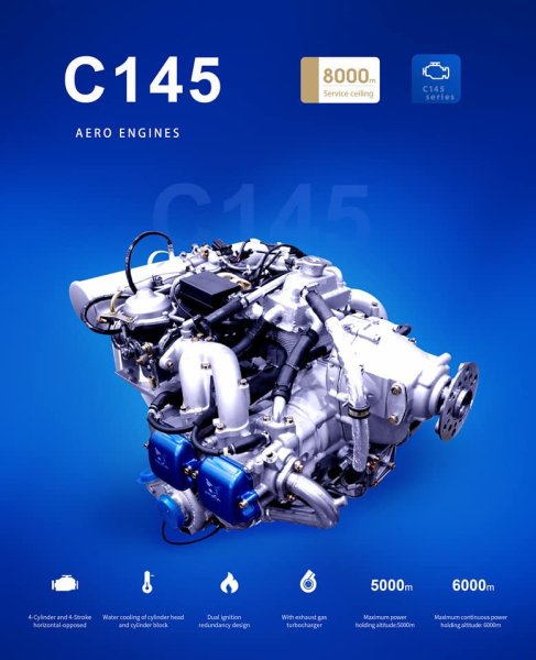

I did talk to the ZOngshen gentleman about getting a single engine at low cost to demonstrate to local market (if it was any good). that was 2021 but in the end I bought a used 1900 hour 912ULS.
By the way Kiwi, the 914 'lookalike' was 30k aussie. 912uls lookalike was 16k aussie.
I wonder if they followed suite of rotax when rotax recently in a service bull uprated all the exhaust valves in the 914  ?
I  spent a fair bit of time on their site. Not really impressed with their targeted market. I doubt there's any way it would be certified. Of course the Chinese can make good stuff but making money is what they are best at (and gambling).. Nev
