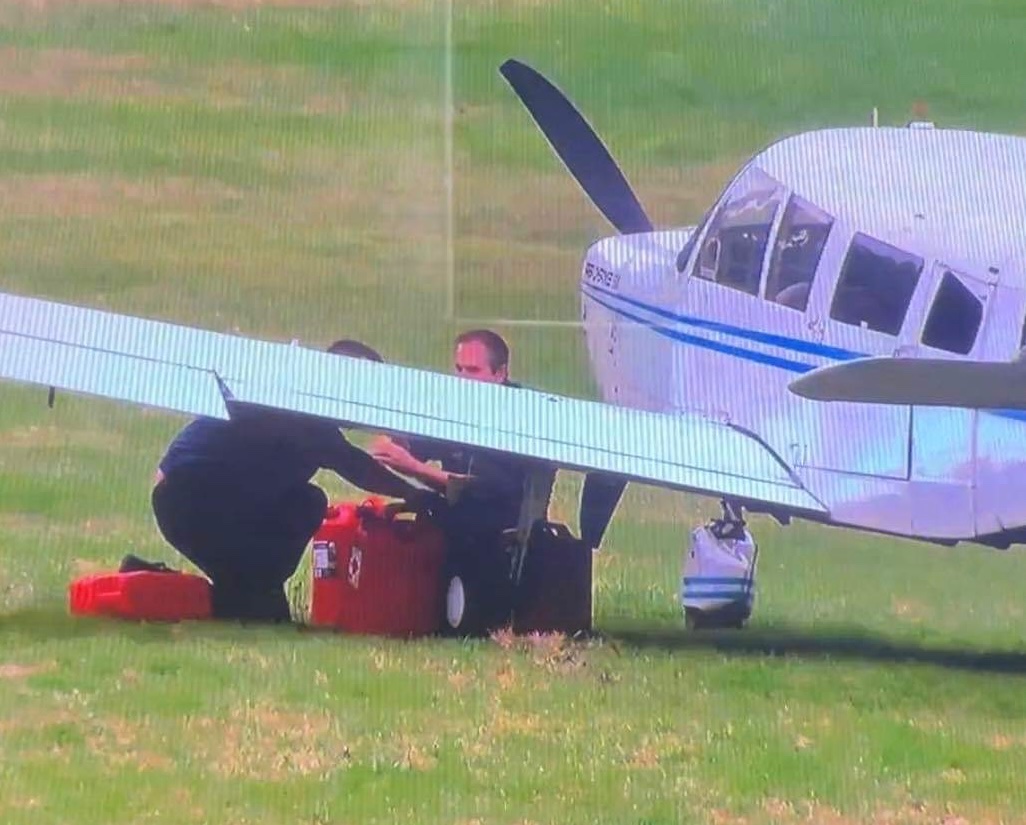

danny_galaga Posted February 9, 2023 Posted February 9, 2023 On 06/02/2023 at 7:48 PM, Cc Evangeline said: This narrative can simply not be true. I was at the trail today and this story came straight from the mouth of an onlooker who claimed “it would’ve been an easy landing”… I disagree. No engine failure is easy. The news report discredited the story from the moment it displayed footage of the fuel tanks being drained. I’m not sure what they could be draining if there was no fuel? (See image below from channel 9). The news reporter said that they really didn’t have much information so have obviously chosen to use what they had. They have quite clearly spun this way out of context, clearly not with any general aviation knowledge themselves. The Pilot has done an amazing job, and executed his training well. Could be taking samples for testing? 1
