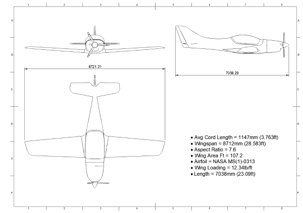

The stress analysis I've only been able to test on componentry, bulkheads, firewall, landing gear. as far as the airframe goes that's something I think that will have to be done and tested/experimented with once i have a test airframe built, same as for CG and so on, i can only do so much in CAD and CFD and it will be something when it comes down to vibration, flutter and twist load tests will need to get further expertise on. as far as the design goes, wing position, airfoil, aspect ratio angle of incidence, dihedral, pilot position, control surfaces, washout i have based that all of various existing aircraft I've studied and what I was wanting to achieve, I've spent countless hours going through many plans sets, talking to Engineers and trying to get everything where it needs to be but really there is a lot to be tested outside the CAD Programs
I looked at a lot of aircraft of similar size that I was wanting to design, took a bunch of measurements off aircraft like the SportStar, TL Sting, Pulsar XP, Falco, Lancair 320 etc. and have tried to work within similar bounds. started with a sketch how I wanted it to look then altered it to suit the important things
As far as performance goes, looking realistically at 120kn cruise on a tricycle config, 45kn stall all originally to run on a Rotax 912uls. wing has 1.8 degrees angle of incidence, 4 degrees on the dihedral, seating is at 35 degrees, washout is 2 degrees, around 290-310kg empty with a 912ULS, wingspan is 8.77mtr
I'm in no way an expert and am very much learning as I go and have altered the design many times to correct issues as I've developed more knowledge around it. Obviously a safe and stable aircraft is priority, but I also wanted a nice looking aircraft. I started with some reference points and designed around that.
Really, I wanted something that was a little quicker than a Sporty but still stable and easy to fly, something fitting for RAAUS 600mtow
End of the day, I'll keep changing the design until its where it needs to be structurally and aerodynamically so it's a safe and stable aircraft, but I feel it's pretty close, I think I need to actually build an airframe and refine from there, I have a few design ideas I want to try and experiment with and for me I can only really do that with a physical part/airframe.
