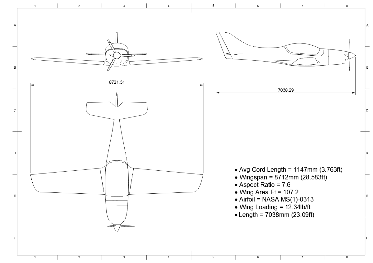

has 107 sq ft of wing area as it sits, attached is a quick spec sheet to give some more insight, and while I'm tinkering away with a retract option, ultimately it will be standard fixed tricycle. I firmly believe for RAUS it is the most suitable
Posted (edited)
have you got pilots sitting over the wing spar, in front, or behind ?
I'd also like to see +6g for these planes, so the Va doesnt get too low.
IMO, that's a potential hazard in these land-slow but  fly-fast slippery airplanes.
120 kts (IAS) is not that much use if Va (clean , at half fuel and  1 POB) ) is 75 kts etc.
Edited by RFguy
between- as in forward, aft of mainspar of person CoM on the spar? What's the CoG location look like with no fuel in the fuel tanks (assuming forward of mainspar)  and max people and baggage ?
I see a few low wing aircraft that with nothing in the tanks(which are often forward of the mainspar) and full peeople and baggage, marginal CofG condition.

Working through that over the next few weeks to make sure it's going to work where it is. Will keep you upto date

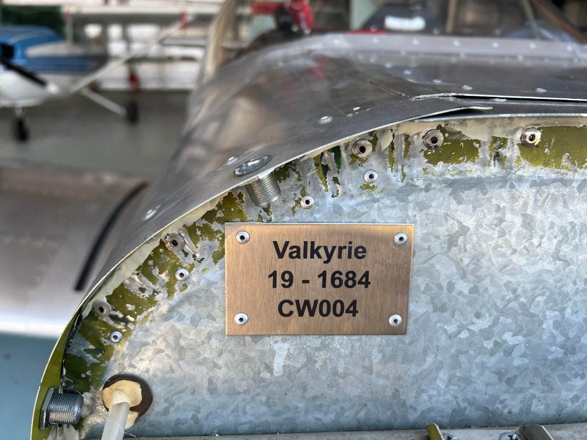

On 18/01/2024 at 5:33 PM, Peasant_Pilot said:
I might look a name/model name change, makes sense if someone has it already
On 18/01/2024 at 5:40 PM, Blueadventures said:
This is its plate if any benefit to you. I did its condition report for change of ownership.
On 18/01/2024 at 6:02 PM, Peasant_Pilot said:
Appreciate the heads up and info mate
BTW P-P,
Chris Weber, the builder of Valkyrie 1684, has said that he feels no special proprietary rights over the name for that one-off of his, so there'd be no need to change it on his account, at least.  If you want to confirm that with him, let me know.
