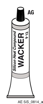

Red Posted June 7, 2024 Posted June 7, 2024 Sigh....Its there to simply fill voids with something more heat conductive than nothing (there are many many voids in the crudely machined threads of a spark plug) Go tell the many people who fried their CPU because they forgot to apply thermal paste that it doesnt work This https://www.aircraftspruce.com/catalog/cspages/silheattrans.php is not the same thing as silicone sealant 1

skippydiesel Posted June 8, 2024 Posted June 8, 2024 Hi BurnieM, I refer you to Rotax 912 Line Maintenance as earlier stated Rotax, MAINTENANCE MANUAL LINE, Chapter 12-20-00, Page 57 "...................... Apply heat conduction compound sparingly and do not apply to the first three threads. Apply small amount of heat conduction compound to spark plug thread and tighten spark plug to 16 Nm (142 in. lb) on the cold engine
facthunter Posted June 8, 2024 Posted June 8, 2024 Skip. Silicone is not the kind of MUCK you want on a spark plug thread. It's weird stuff and is not a CONDUCTOR of heat. ALL these things will alter the tension feel. The washer crushes and you can feel that situation by hand. Heat removal from the spark plug body is not an issue if it's TIGHT. Thread wear could occur in aluminium, particularly with shorter reach plugs or ones that have been out of the Package floating around in a tool box. allowing tread damage and then there's the odd cross threading possibility. Nev
sfGnome Posted June 8, 2024 Posted June 8, 2024 (edited) Without wanting to get involved in this discussion, it’s worth noting that ‘silicon’ is not ‘silicone’. I think you’re talking about two different things. Edited June 8, 2024 by sfGnome
facthunter Posted June 8, 2024 Posted June 8, 2024 Silicon is in sand and glass. It's also sometimes used in aluminium alloys to lower the thermal expansion rate. It makes the alloy harder and more brittle and more dense. I can't recall the word "silicon" used in this discussion prior to now. Nev

sfGnome Posted June 8, 2024 Posted June 8, 2024 9 hours ago, facthunter said: Silicon is in sand and glass. It's also sometimes used in aluminium alloys to lower the thermal expansion rate. It makes the alloy harder and more brittle and more dense. I can't recall the word "silicon" used in this discussion prior to now. Nev The picture of the Wacker tube says ‘silicon’. 1

facthunter Posted June 9, 2024 Posted June 9, 2024 I've explained it fully all the way through. Rotax do suggest a few funny things at times. It's NOT blasphemy to question it. Plug heat transfer is NOT an issue. Silicone is not good at transferring heat. I do have a long and extensive experience with many kinds of Motors. Not just U tube. WHY BOG up threads with silicone? It's extremely difficult to clean off. It has VARYING outcomes. . Expensive and NOT necessary. On electrical sinks it holds the two pieces together in close proximity. You don't create a thick blob. Nev . 1 1

skippydiesel Posted June 9, 2024 Posted June 9, 2024 2 minutes ago, facthunter said: OK Hands up who has ever had a cooked spark plug in a 9xx motor.? . Don't tell me everyone uses wacker or something. Where are the examples?. Nev If you purchase your Rotax plugs B from Floods, you have the option, for a small fee, to have the threads "treated" with the appropriate paste - I have never asked what brand but assume they would use Wacker P 12. This does not mean that all patrons of B Flood, go to the added small expense, however my money is that most will and those that don't will apply their own.
Blueadventures Posted June 9, 2024 Posted June 9, 2024 17 minutes ago, facthunter said: OK Hands up who has ever had a cooked spark plug in a 9xx motor.? . Don't tell me everyone uses wacker or something. Where are the examples?. Nev I have used Wacker on all plugs; bought a tube of it in 2010 for $18. Plugs have been good ULS now and UL previously. 2
