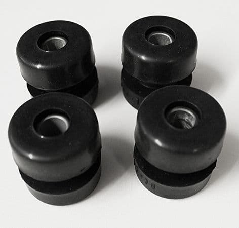

Moneybox Posted November 21, 2024 Posted November 21, 2024 (edited) 7 minutes ago, BurnieM said: You also need to be a bit creative with BF. for example for a 912is the fuel pump upgrade kit with 2 pumps is about $900 whereas a single pump is $1400. I like to support local suppliers but sometimes they don't do their best to support us. I bought both my pumps from Evektor and even with the import freight I saved a considerable amount of money. I got a tube of Wacker P12 paste thrown in too 😀 Reduces vibration Accommodates high shock forces Reduces stress on brackets and fabrications Can absorb shock efficiently for millions of cycles Sandwich either side of mounting hole to “float ” the fixing bolt Has strong metal core What’s in the box: 4 X 2 part bushing Other sizes available on request Bushings “float ” the mounting bolt Diameter: 33mm Male part flange height: 12.3mm Washer height 12.3mm Mounting hole diameter: 20mm Overall height: 34mm Washer -hole diameter - 14mm Metal core runs the length of the male part I'll need two of these...AU $53.49 each set Edited November 21, 2024 by Moneybox
Thruster88 Posted November 21, 2024 Posted November 21, 2024 12 minutes ago, Moneybox said: I like to support local suppliers but sometimes they don't do their best to support us. I bought both my pumps from Evektor and even with the import freight I saved a considerable amount of money. I got a tube of Wacker P12 paste thrown in too 😀 Reduces vibration Accommodates high shock forces Reduces stress on brackets and fabrications Can absorb shock efficiently for millions of cycles Sandwich either side of mounting hole to “float ” the fixing bolt Has strong metal core What’s in the box: 4 X 2 part bushing Other sizes available on request Bushings “float ” the mounting bolt Diameter: 33mm Male part flange height: 12.3mm Washer height 12.3mm Mounting hole diameter: 20mm Overall height: 34mm Washer -hole diameter - 14mm Metal core runs the length of the male part I'll need two of these...AU $53.49 each set Hi Moneybox. I need some of these for a Thruster, were did you find them?

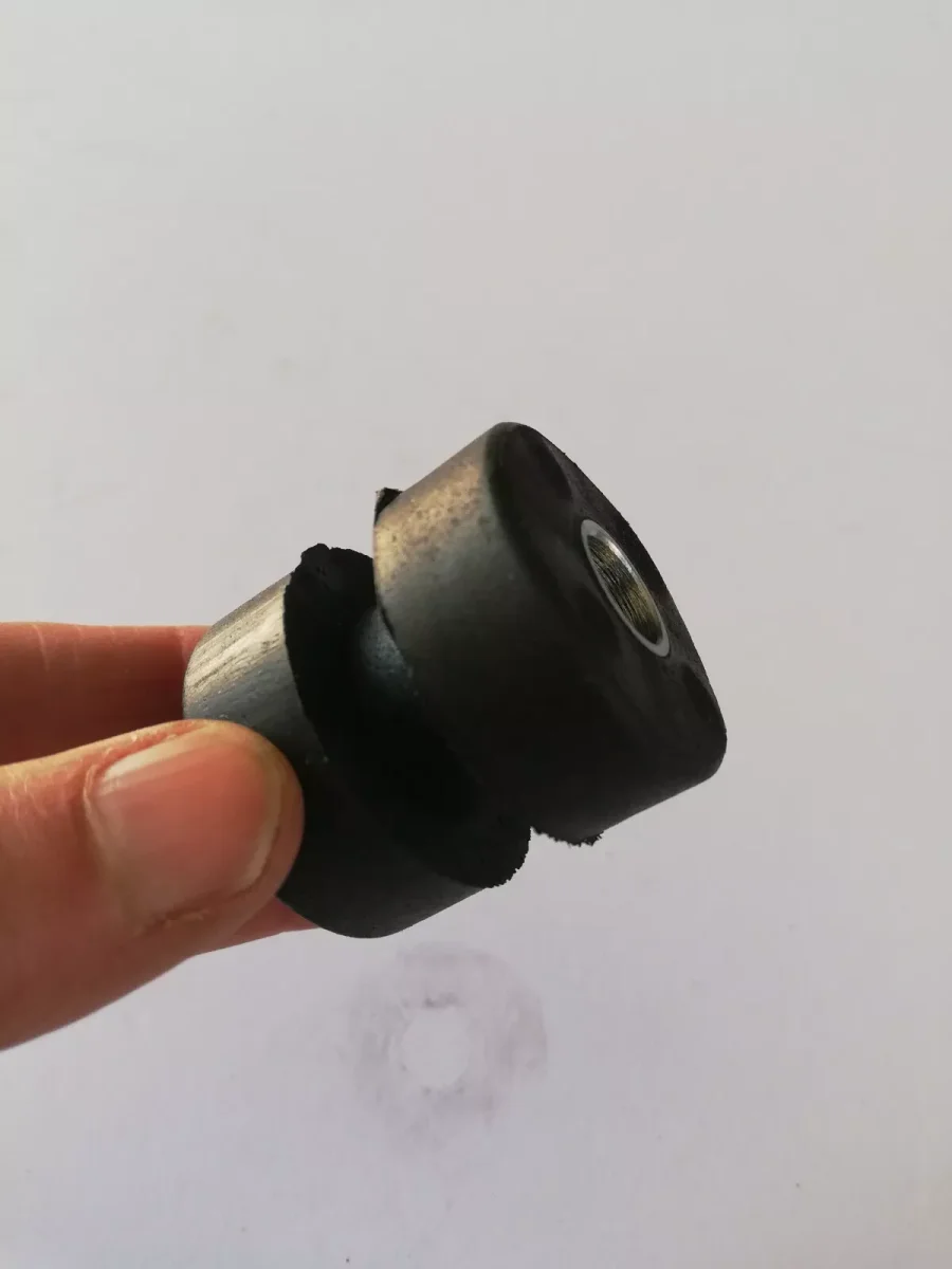

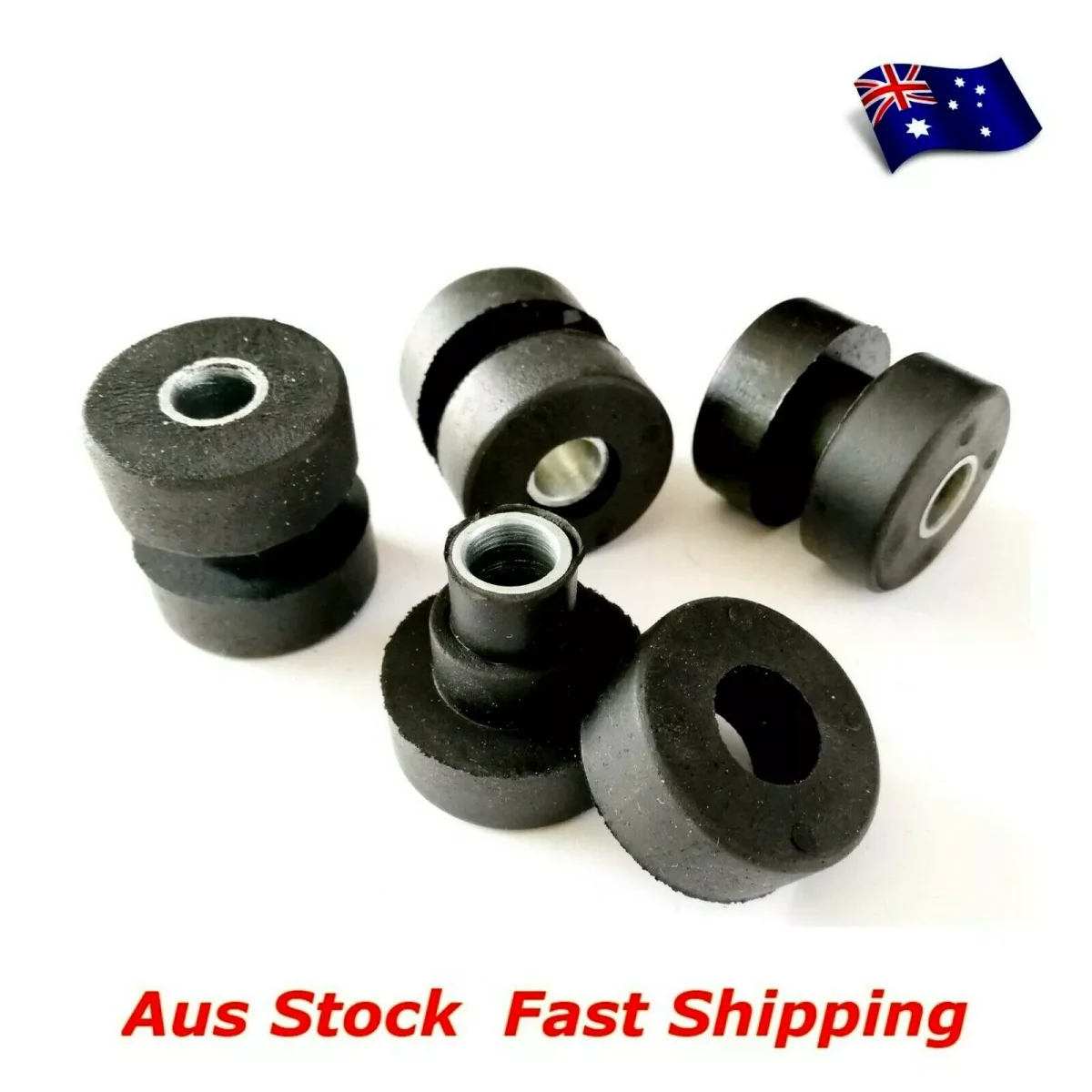

Moneybox Posted November 21, 2024 Posted November 21, 2024 7 minutes ago, facthunter said: Keep oil away from rubber. Nev I'd like to think oil wouldn't get to the firewall. 1 minute ago, Thruster88 said: Hi Moneybox. I need some of these for a Thruster, were did you find them? https://www.ebay.com.au/itm/282619998576?chn=ps&_ul=AU&norover=1&mkevt=1&mkrid=705-139619-5960-0&mkcid=2&mkscid=101&itemid=282619998576&targetid=2370955762951&device=c&mktype=pla&googleloc=9070701&poi=&campaignid=21766114506&mkgroupid=168279963077&rlsatarget=pla-2370955762951&abcId=10047372&merchantid=116482553&gad_source=1&gclid=CjwKCAiArva5BhBiEiwA-oTnXT9iMnI5oiIcr9uRKu4dvavDSPITMGcNUW2Yl0hiGLgb7L1i3KFFURoCG0cQAvD_BwE I've not confirmed that these are suitable but they look to be about right. They say other sizes available. 2

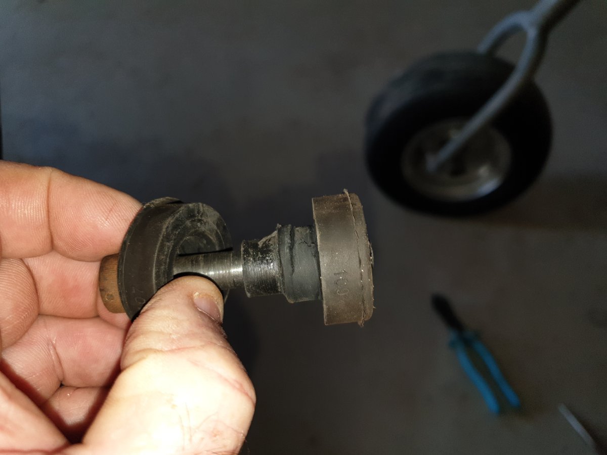

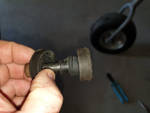

Moneybox Posted November 21, 2024 Posted November 21, 2024 I've just removed one for a look. I'll take some measurements. 1

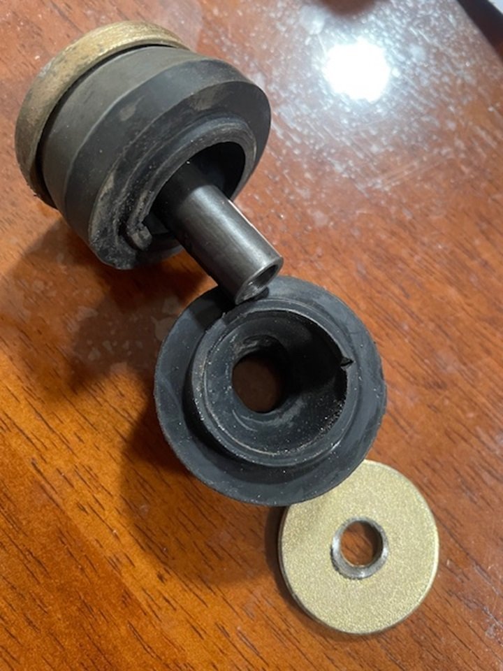

Blueadventures Posted November 21, 2024 Posted November 21, 2024 43 minutes ago, Thruster88 said: Hi Moneybox. I need some of these for a Thruster, were did you find them? These are the Skyranger ones. 13 pound a set at Flylight Airsport UK. (Image apart is the ones I replaced on a Skyranger last year.) 3

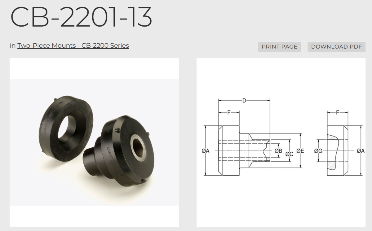

Blueadventures Posted November 21, 2024 Posted November 21, 2024 1 hour ago, Blueadventures said: These are the Skyranger ones. 13 pound a set at Flylight Airsport UK. (Image apart is the ones I replaced on a Skyranger last year.) Lord Mounts Part No. CB220113 from Flexible Drive are the same size and used over here; I am told by another Skyranger owner in Australia. However I purchase from the manufacturer. 2

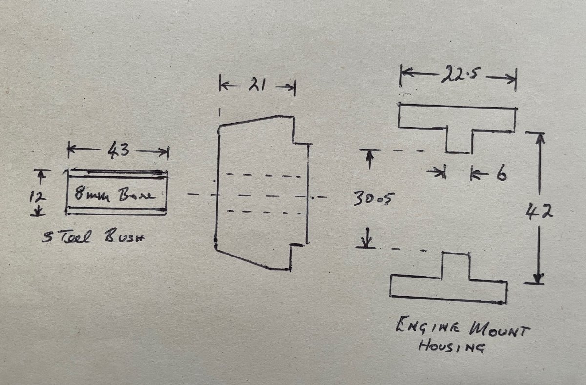

Moneybox Posted November 21, 2024 Posted November 21, 2024 This might do the job to some extent although the E-size is only 20mm inserted into a 30mm hole in the housing?
Blueadventures Posted November 21, 2024 Posted November 21, 2024 6 minutes ago, Moneybox said: This might do the job to some extent although the E-size is only 20mm inserted into a 30mm hole in the housing? Maybe phone flexible Drive and ask if they have same compond grade in your sizing. 1
