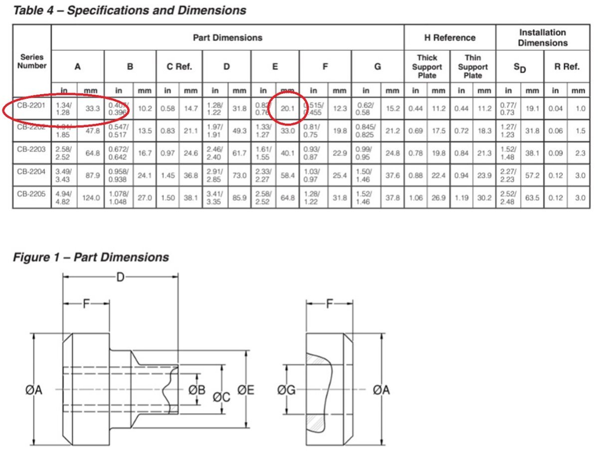

Moneybox Posted 6 minutes ago Posted 6 minutes ago I can't see me being happy with any of these mounts so far. The centre rubber is only 20mm when I need 30mm to support the frame. I could simply make up a bush to take up the slack but then I have a problem with the OD. It's only 33mm and with a hole in the frame at 30mm it's barely hanging on. That's unless I've read it wrong but that's never happened before 😇
