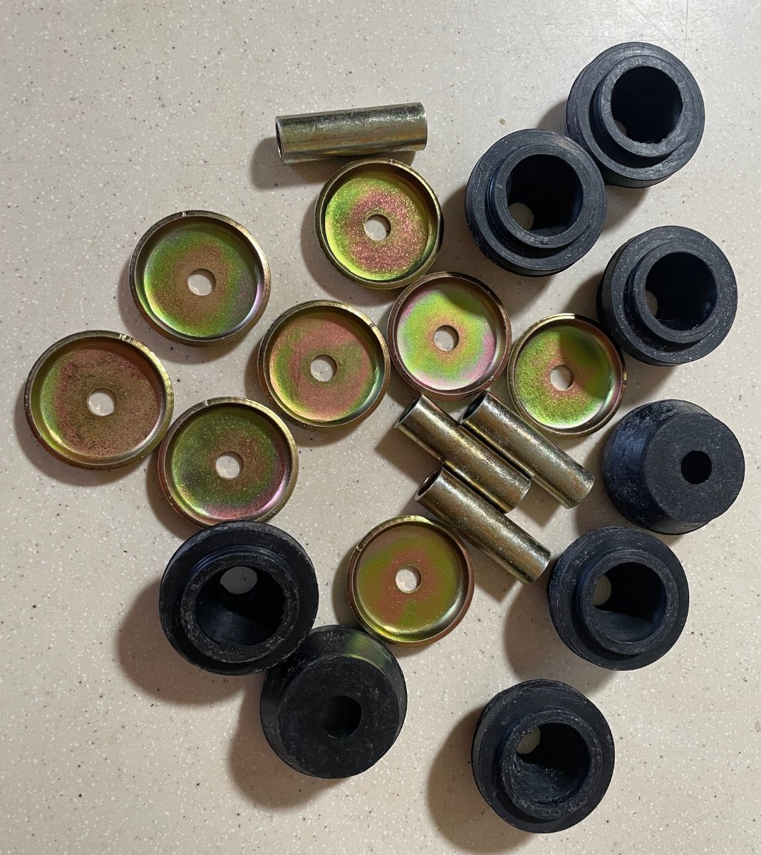

Moneybox Posted December 23, 2024 Posted December 23, 2024 It was nice of the Czechoslovakians to hold off and deliver my engine mounts for Christmas 😁 2 4
