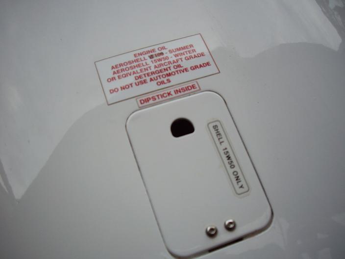

Guest brentc Posted May 4, 2008 Posted May 4, 2008 This was taken today from the bonnet of a brand new J170. It's quite clear that 15w/50 is the only oil to use.
facthunter Posted May 4, 2008 Posted May 4, 2008 Clear??? You've got 2 contradictory statements. One refers to the engine oil. perhaps the other refers to the hinge of the access panel? (just kidding, but you would think that there would be one only instruction). Nev..
