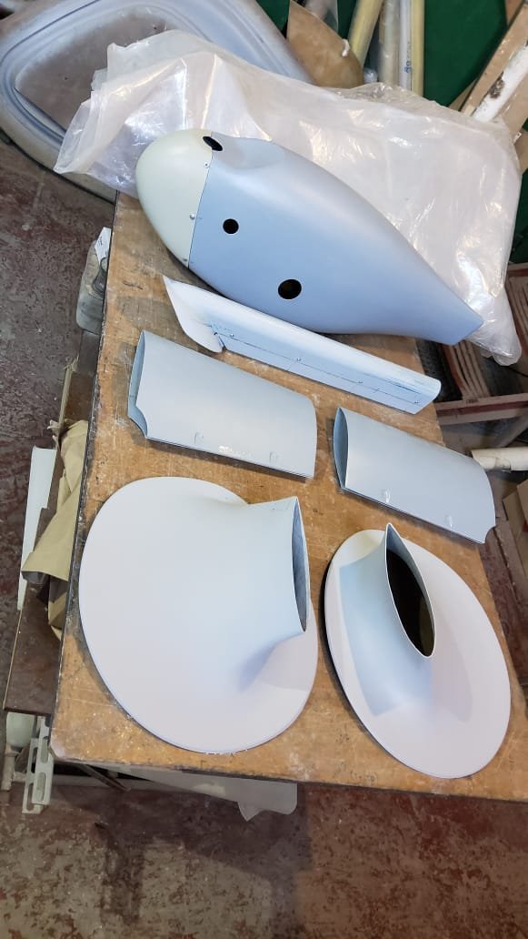

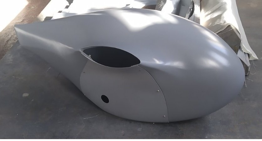

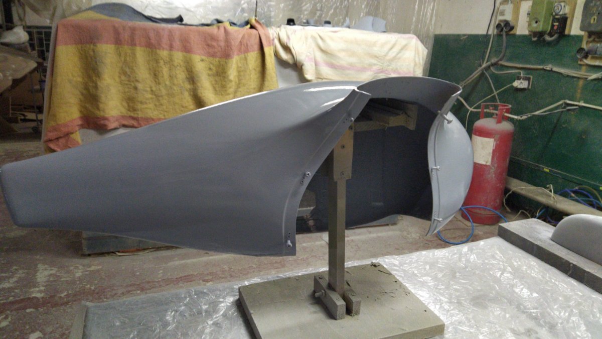

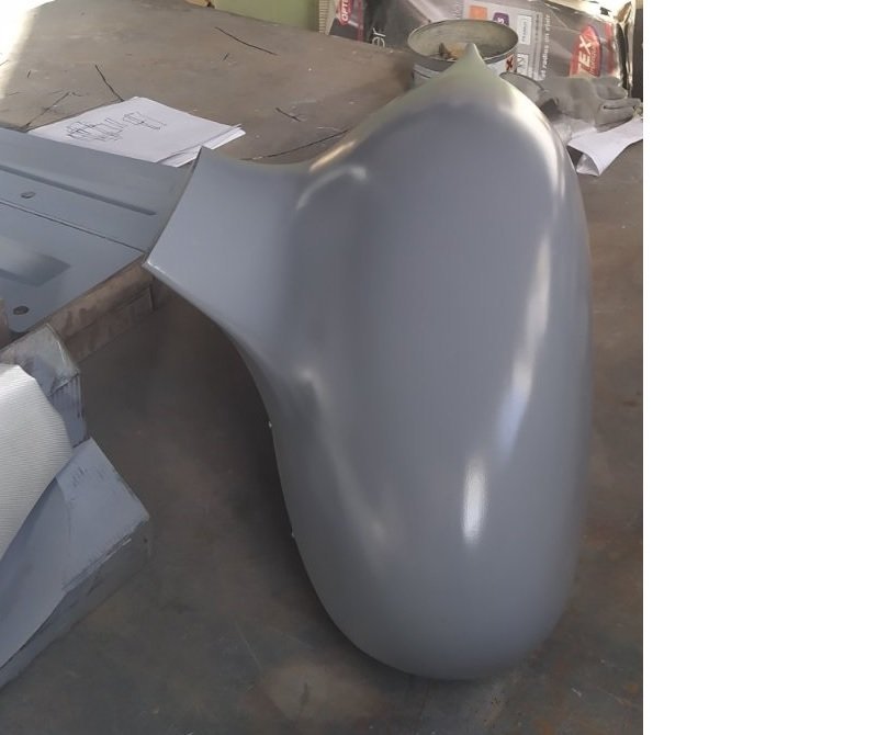

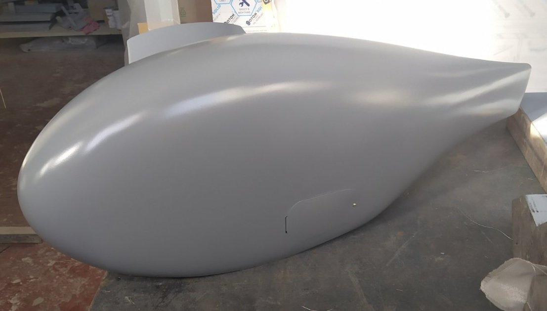

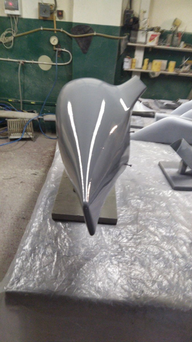

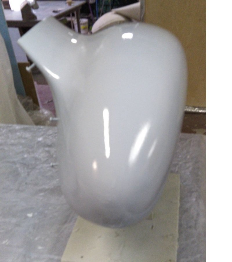

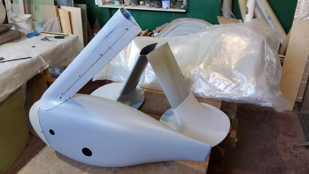

meglin Posted March 30, 2023 Posted March 30, 2023 Which wheel pants are preferable - fiberglass or carbon? We believe that epoxy fiberglass obtained by vacuum molding with heating is the optimal solution. Such fiberglass is durable, light, resistant to ultraviolet and moisture, cheap, has a large life. However, now at the peak of popularity are products of carbon. Indeed, its unit strength is higher, the stiffness is also higher. As for the price, we have to offer carbon products 1.5 times more expensive when it is primed externally. When using decorative carbon with transparent coating, the price increases 2-2.5 times. We think it is too expensive. But fashion dictates its rules, wishing a lot. Maybe we are wrong and do not know something? 1
rgmwa Posted March 30, 2023 Posted March 30, 2023 Beautiful work! I would not pay the extra for carbon fibre. I don’t see much value in using it for wheel pants. 1 2
turboplanner Posted March 30, 2023 Posted March 30, 2023 Since these items take a beating and are easily scratched or broken, repairs and replacement are probable, cost and skill level required is important. The surface area is small so Carbon Fibre's weight saving is not a big advantage. If a solid object is hit at speed the FRP will crack or split, but can usually be held together for the repair without going back into a mould whereas the Carbon Fibre one will be in a dozen pieces and non-repairable. I'd prefer FRP. 1
