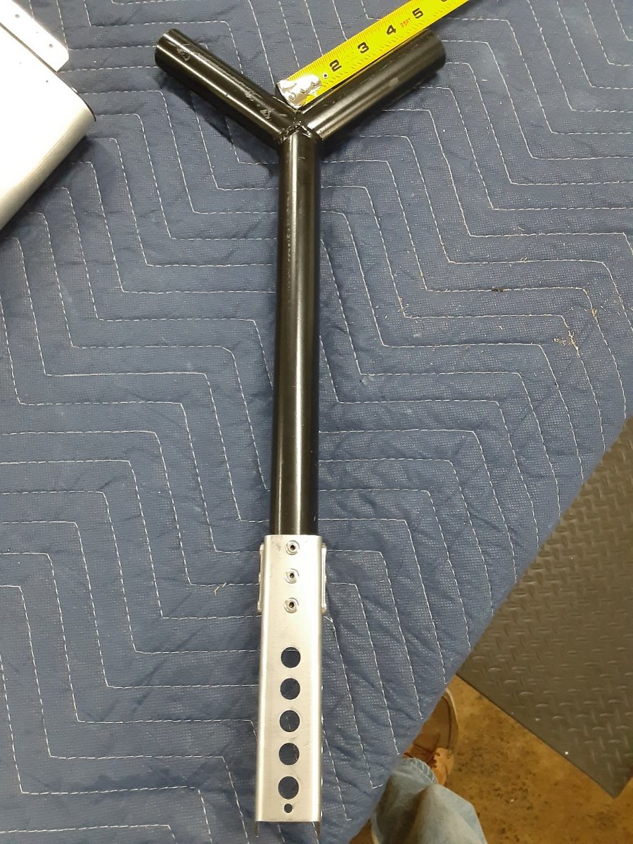

BC0979 Posted April 4, 2023 Share Posted April 4, 2023 This is personal preference but I do not like the supplied rubber grip that came with Kit #1. I like a simple textured motorcycle style grip that you find on the motorcycle throttle. The issue I am having is our Y control Stick tube diameter measures 1.140 which I am assuming is a 1-1/8 inch grip. My research shows that the majority of grips are for 1 inch or smaller. Has anyone found a supplier for a simple grip like the Ray Allen G205? According to Ray Allen, this will not fit. They suggested the G300 series which is more of a fighter pilot/gaming stick. What are you using???? Link to comment Share on other sites More sharing options...

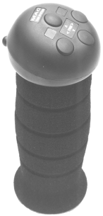

Bodie Posted April 5, 2023 Share Posted April 5, 2023 The stock rubber grip is something I remember from 55 years ago on my tricycle! I chucked it and used the ray allen g205 that I got from aircraft spruce. I had to do a slight bit of modification but I can’t remember exactly what I did. I can take a look next time I’m in the hangar. It wasn’t hard to get to fit up. -steve Link to comment Share on other sites More sharing options...
BC0979 Posted April 5, 2023 Author Share Posted April 5, 2023 The Ray Allen G205 would be exactly what I am looking for, but when I contacted Ray Allen they told me that it would not fit our 1-1/8 stick without splitting. Link to comment Share on other sites More sharing options...

spacesailor Posted April 6, 2023 Share Posted April 6, 2023 Someone ' welded ' that joystick, so would it be such a hard job to cut off the offending 1 1/8" , tube. And replace it with the standard 1 " tube , that will be covered with your ' preferred ' grip . OR Get a Nice piece of wood & cut & shape to fit around your 1 1/8" tube .. ( whittle away a few hours while relaxing ) . Could be two halves ' araldited ' together . Nicer feel to a ' wooden handle ' . Just a thought. spacesailor Link to comment Share on other sites More sharing options...
Bodie Posted April 6, 2023 Share Posted April 6, 2023 I looked at my Savannah to remember what I ended up doing, and here are some pics. Not sure if this explains well enough, but I made a hacksaw cut appx 70-75% around the end of the yoke, then I resized the pipe. I can't remember if the y yoke pipe is smaller or larger than the plastic end of the grip that inserts into the y yoke (see pdf). I then fit the G205 head into the yoke and rivited it in on opposite sides. You have to be mindful of the rivits ends so that they don't interfere with any of the electronic parts inside of the plastic. The foam grip went on before this with soap and water, then it was gently worked up. It fits well. I have to find another foam grip so that I can junk out the tricycle handle bar grip on the other side. Hope this helps. -steve 2023-04-05 (1).pdf 1 Link to comment Share on other sites More sharing options...
BC0979 Posted April 7, 2023 Author Share Posted April 7, 2023 Bodie, Thanks for the pics and explaining how you mounted the g205. Seems straight forward. Link to comment Share on other sites More sharing options...
