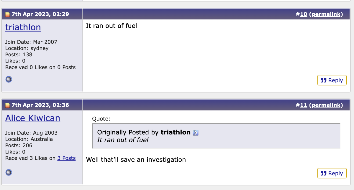

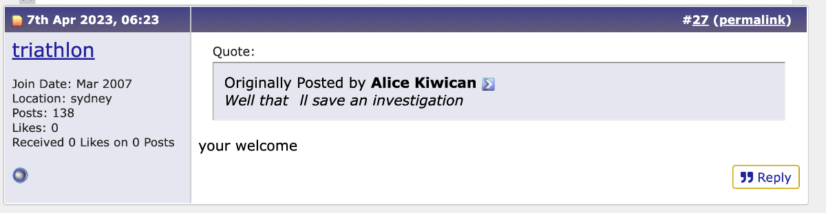

Garfly Posted April 10, 2023 Posted April 10, 2023 (edited) On 10/04/2023 at 3:54 AM, flying dog said: Maybe not, but it is PUBLIC and not based on facts. I want to be clear I am not trying to assign blame. But the "picture" as painted is still too vague to know the real story of what happened to start guessing the cause. Expand Fair enough. (Over on pprune, though, they're pretty hairy-chested with their speculatin' ;- ) Edited April 10, 2023 by Garfly 2
flying dog Posted April 10, 2023 Posted April 10, 2023 Maybe not, but it is PUBLIC and not based on facts. I want to be clear I am not trying to assign blame. But the "picture" as painted is still too vague to know the real story of what happened to start guessing the cause.
flying dog Posted April 10, 2023 Posted April 10, 2023 Shame that it got to that. I know no one is perfect, but gee it is not nice when pilots - who are supposed to be just a bit better than most others at blame assignation - are doing that.
flying dog Posted April 10, 2023 Posted April 10, 2023 The big thing there is the word IF. How about we wait for truths to be revealed? Yes, it would be better if we can learn from it but first we have to know if that is/was the cause. 1
Garfly Posted April 10, 2023 Posted April 10, 2023 (edited) Actually, there's little incentive not to speculate on a fellow pilot's 'error'. Notwithstanding our precept about innocent till proven guilty. Some will argue that there's a public benefit in doing so (rarely argued by an involved party). Truth is, most aeronautical types can take a guess as to the probable cause as soon as they hear the basic facts about an incident. After all, we haven't found too many new ways to crash planes in the past century. (Old Dan Gryder certainly does, even if sometimes he's forced to eat humble pie due his high profile.) So if you've no scruples about pointing fingers you will very likely be (partly) right. And anyway, by the time a properly responsible investigation is done, your premature gaff will likely be forgotten. (Except, probably, by aggrieved innocents - and unless they decide to sue ;- ) Edited April 10, 2023 by Garfly
facthunter Posted April 10, 2023 Posted April 10, 2023 The impression you get from Prune is Hell, are these weirdos up the front of the things I fly in?? Might have changed I only look now and again. Nev
