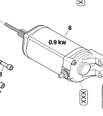

BrendAn Posted October 11 Posted October 11 49 minutes ago, facthunter said: It's there and it's a good idea and you can see the corresponding support cast into the piece it bolts to. It may be a link Cantilever small dia shafts are a bad idea unless they act as a QUILL and deliberate break point for an overload situation. Gear mesh must be maintained to a close tolerance on load or the gear strength is compromised rapidly and teeth fail. They will also run noisily when on load.. Nev i think you are talking about the mounting bolts. if you look at the service bulletin danny posted there are 2 long bolts , no pin. 1
Red Posted October 11 Posted October 11 2 hours ago, BrendAn said: i think you are talking about the mounting bolts. if you look at the service bulletin danny posted there are 2 long bolts , no pin. Exactly, but I've had enough of Facthunter and the mysterious pin that only he can see, Its like asking a Trump supporter to accept he didnt win the last US Election.🙄 1

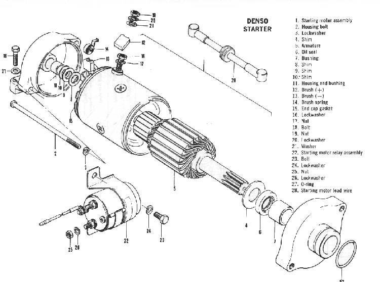

Red Posted October 11 Posted October 11 For info, here is an exploded layout of a typical Denso motorcycle starter of the type Rotax seem to be using. 1

danny_galaga Posted October 14 Author Posted October 14 Fact Hunter, there's a lot to scroll through, can you describe in simple terms what this pin is doing, and what it goes in to? When I had my 912 starter out, I noticed nothing remarkable about it except that is a Denso motorcycle starter motor. I don't specifically remember a pin somewhere, but I wasn't looking for one either. 1
BrendAn Posted October 14 Posted October 14 the only thing i can see is the mounting bolt which does look like a pin in this pic. 1 1
danny_galaga Posted October 14 Author Posted October 14 3 hours ago, BrendAn said: the only thing i can see is the mounting bolt which does look like a pin in this pic. Oh yes, that's an unfortunate perspective 😄. I can definitely confirm that's just the through bolt and nothing to do with the armature shaft. 2
Red Posted October 14 Posted October 14 (edited) I explained this to facthunter some time ago Danny but he won't listen Whatever I'll report back on the starter I've ordered when I get to trial fit it and try get the thread back on track.😁 Edited October 14 by Red 2 1
facthunter Posted October 14 Posted October 14 Its NOT on the standard Rotax starter and I have never said it was . . Thanks Danny and I've also mentioned the part it mated to . I'm sorry for any confusion caused and sick of the response. . I found a couple of similar starters in my den one being brand new. They have precision ball races in both ends of the armature probably Japanese made unit. The drive gear is much the same and the larger gear it meshes with is shouldered to make the teeth stronger. It probably has to be forged. . All I'd do with the Rotax unit is remove it and check it periodically as it has bushes to support the shaft and check the commutator and brushes at the same time.. Wear in the bushes changes the gear mesh and may also allow the armature to "Pole". Nev 1
