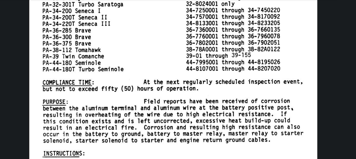

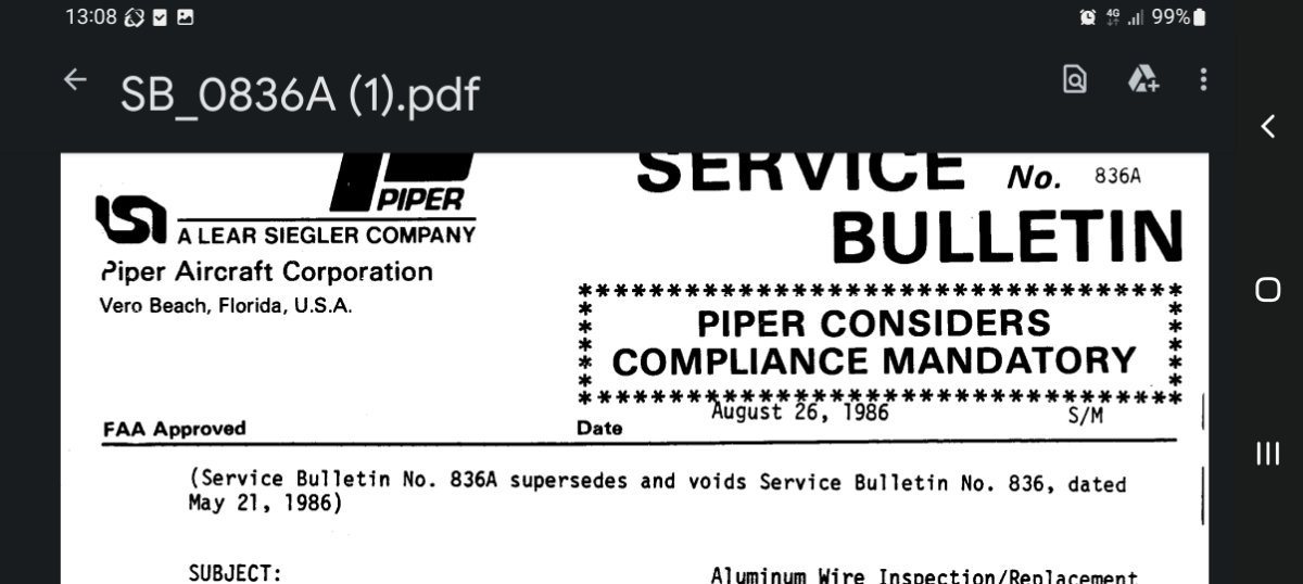

Kiwi Posted April 15, 2023 Posted April 15, 2023 I wouldn't use aluminium cables, Piper issued a SB years ago about aluminium starter cables, can get a STC to replace them with copper. 1

Kiwi Posted April 15, 2023 Posted April 15, 2023 Risk of electrical fire was the part that caught my attention. 1
Old Koreelah Posted April 15, 2023 Posted April 15, 2023 36 minutes ago, danny_galaga said: Without looking it up, I wouldn't be surprised if it's to do with fatigue… Thanks Danny. That’s the only downside I can see and it should be easily fixed if the aluminium conductors are sheathed and well fixed to stop the effects of vibration. That Piper SB in Kiwi’s post seems to blame corrosion at junction points for the risk of fire, so that’s my main area of interest: the safest (and lightest) way to join fixed aluminium cables to flexible copper ones.

Ian Posted April 15, 2023 Posted April 15, 2023 Aluminium can be worthwhile from a weight and cost perspective however you need to be mindful of its weaknesses. The piper issues appears to have been with bimetallic corrosion, if you really want to save weight look at lithium batteries first. You can buy aluminium to copper crimps. Bimetal corrosion is still an issue however oxidation within the cable lug is prevented by protecting the internal surface with a specific grease with a very high dropping point. 1
