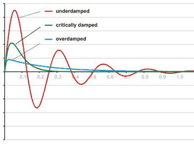

RFguy Posted April 22, 2023 Posted April 22, 2023 The less the tail has to do the better for efficiency. Bruce do you recall, for those gliders when set at the "design aft-limit" , in response to a impulse pitch input (up or down step), in terms of dynamic pitch stability, were they over damped (return very slowly to original attitude) or underdamped (borderline unstable probably aft CG for that airspeed/loading) IE entered an oscillatory condition like a car spring without a damper ) or somewhere in between ?

Area-51 Posted April 23, 2023 Posted April 23, 2023 (edited) On 22/04/2023 at 11:03 PM, RFguy said: The less the tail has to do the better for efficiency. Bruce do you recall, for those gliders when set at the "design aft-limit" , in response to a impulse pitch input (up or down step), in terms of dynamic pitch stability, were they over damped (return very slowly to original attitude) or underdamped (borderline unstable probably aft CG for that airspeed/loading) IE entered an oscillatory condition like a car spring without a damper ) or somewhere in between ? Expand This is a great diagram regarding optimum CG... correlate the image to dynamic pitch stability at best glide. The optimum CG position will result in a stable constant decent at exactly the 'best glide' velocity, with neutral pitch trim... moving the CG rearward will cause the airframe to gradually pitch up until airspeed bleeds off and the nose pitches down once again; and this can repeat all the way down to an actual hands off landing in a perfect environment... moving the CG forward will pitch the airframe nose down, and into the ground.... positioning the CG too far from the optimum best glide position amplifies these effects until dynamic stability collapses... depending upon the individual airframe optimum CG will change either side of Best Glide; which is the primary purpose of pitch control/trim surfaces... A longitudinal sliding mass is the simplest pitch control device, and things can go very wrong when the mechanism fails. Test proofing an airframe design within Xplane is a great way to study affects without getting dead.. one design recently looked at had a violent tendency to barrel roll immediately if the CG was moved beyond the rearward position by just 5.0mm; the spin was mostly unrecoverable when affecting full pitch up deflection during the upper quadrant of the manoeuvring speed in straight level flight moving the CG 5.0mm forward again allowed for instant recovery of a controlled barrel roll. The perfect CG position on the perfect theoretical airframe will see the airframe return to a stable straight ahead vector immediately at any speed through any vectored direction of fluid (air) when all control pressure is released back to a neutral position. Edited April 23, 2023 by Area-51 3 2
