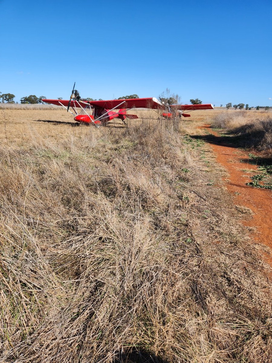

extralite Posted June 4, 2023 Posted June 4, 2023 (edited) Good weekend in the Central West. Dropped into Rabbit Trap hotel in Albert for lunch and then next day a trip to Trundle. Highly Highly recommend the cafe in trundle, great salads etc. Working them all out still and gradually ironing out some issues. They all fly a lot nicer with some weight put on at the back. Obviously with a 582 it would be better to shorten boom at front. Not sure how far. Interesting comparing the different machines. Matey from Leeton somehow managed to make one go about ten knots faster than the others. Not sure how just yet. Unfortunately that one also had the fuel level sighting tube plumbed opposite the fuel line at a t junction off the fuel pump. Discovered this when in the cruise, noticed the fuel level dropping very fast, from 40 liters to 20 to 10 in a few minutes. I thought it must have been a huge fuel leak but at least had a bit of time to make sure i was over a great paddock when the inevitable happened. The good thing about the Thruster glide performance is no wasted time trying to choose which is the best landing field. It looks like at some stage, the engine decided it was easier to draw fuel from the sighting tube than from after the fuel line itself. Whether it was a fuel pump issue or filter not sure yet. It ran fine after that but will replace both and change the sighting tube pick-up. Fun machines, everyone that has flown one around here loves them. Edited June 4, 2023 by extralite 5 1 2
