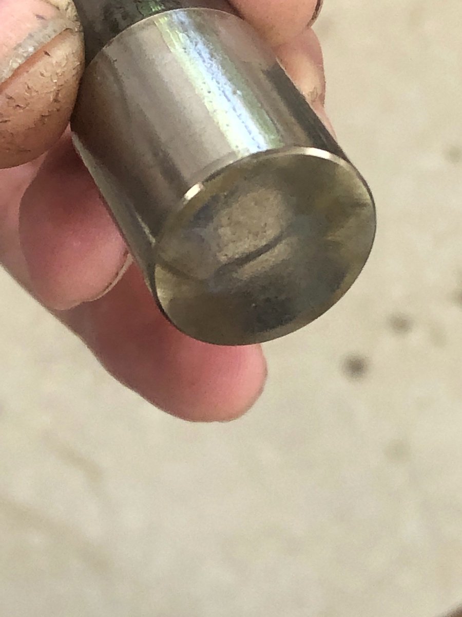

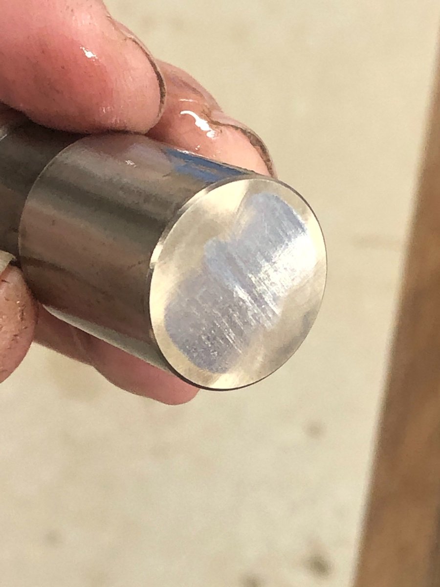

No, i did not answer my question well enough. Rotax have changed the part number for both the lifter and lifter set a lot prior to 2008, and a few times since.
Today I tore down an old 912 and it did not have Johnson lifters in it, and they still looked ok after 2000hrs use, where as the Johnsons are heading to the bin at just 100hrs. (Maybe they were a bad batch).
Does anyone have any info on this?

What's your failure mode? Bottom contact surface? Those lifters are built with close tolerances but they are cheap because so many are made.  They are only hard cast iron.  Nev
I'm informed that Most of that stuff available here  now is from China.. That style of lifter is  heavy compared to other designs that are available in more modern motors Nev

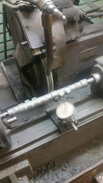

The engine hasnt been run yet. My cousin is a racecar engine builder and he rebuilt the engine for me. It is also fully balanced and has a big bore kit fitted. He is also a Rotax certified engine repairer as he is a pilot and instructor as well.
He told me he used the ford lifters as they were the best. The main thing is the cam grind. He did the cam as well. The lifters must rotate as the engine turns over otherwise the cam lobe of lifters will wear. This is my engine

4 out of the 8 lifters were not rotating as required; end of story. The other 4 lifters are as good as new.

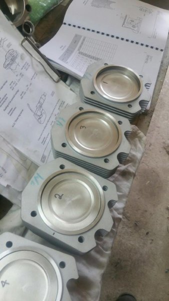

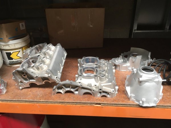

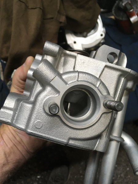

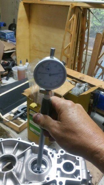

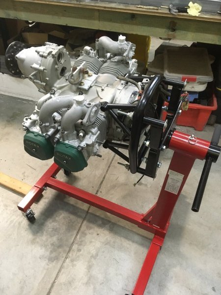

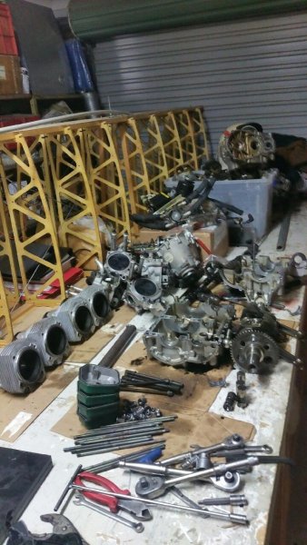

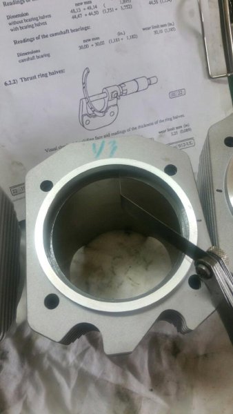

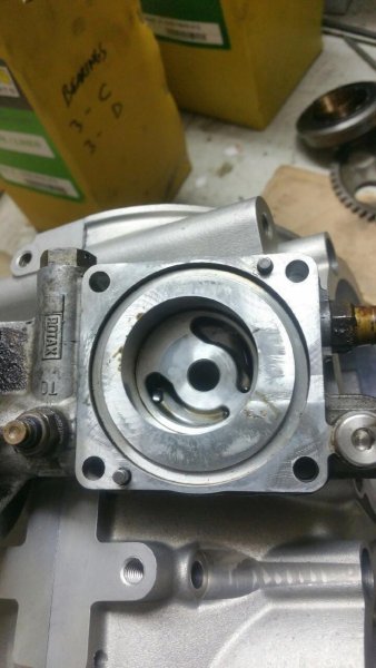

I am not sure. I trust Jim's experience and vast knowledge on what to put in engines and how to rebuild them. He does all the machining himself and also the cam grinding. The cam lobes must have a slight curve at 90 deg to the cam lobe. This is what makes the lifters rotate that little curve and it cant be too much or too little either it has to be just riht he tells me. All I know is they are lifters for Ford engines. He also has a engine balancer and a heap of gear there. He is always flat out doing engines for the racing guys that when you give him a job to do for a relative you have to be patient as he does it as he gets the time. Some pics of the rebuild from when I got the engine. It was a 2000 hr 2015 engine that had been well maintained out of a Tecnam at a local flying school. You can see the cam being reground20191025_230002.thumb.jpeg.4e72bd7b0446748de295f4c201c34fad.jpeg20200205_134520.thumb.jpeg.739de7f415735140a602eb1baf50072c.jpeg20200205_140046.thumb.jpeg.4d3e0d4a44c5c7ffebbafc8c81905e92.jpeg20191105_200301.thumb.jpeg.e73b8b760bba119a17229e4eb715f314.jpeg20200206_114754.thumb.jpeg.29910d6380691a636c4b979131db9e3d.jpeg20200206_115036.thumb.jpeg.63fa40cd09397b8342c360bc750dea20.jpeg20200206_120235.thumb.jpeg.092d622c9ecbd0b1033023acb49f70ff.jpeg20200206_122626.thumb.jpeg.2884e50214ac1855a13644dad5acba98.jpegIMG_8257.thumb.jpeg.bb65ccdae245d8a7e1e07e9760c4f2f6.jpegIMG_8256.thumb.jpeg.2ec97fa051d3fc5c9b3c98b44827f8fb.jpegIMG_8255.thumb.jpeg.9f8431d39ba82447b99f365de812774a.jpegIMG_8254.thumb.jpeg.536319d398a4ad98d67c9169c2c0c5c9.jpegIMG_8215.thumb.jpeg.295cefd464d5a155d41f9031c4f4fd78.jpegIMG_8486.thumb.jpeg.a3bc7fc3d6189d669cddfae05ef1811e.jpeg
Lucky you! Should run really nice. They are a really simply and sweet engine.
