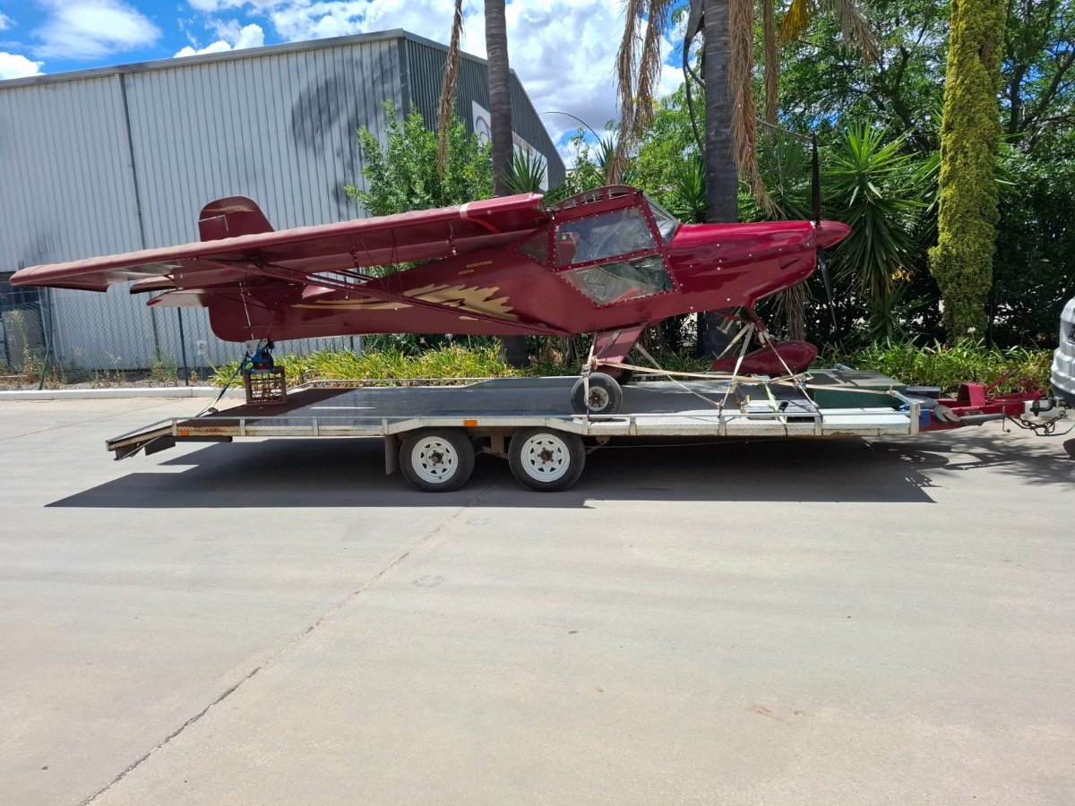

BrendAn Posted February 16 Posted February 16 We actually folded the wings to make room in the hangar. That's all. If I had one I would make up a trolley with castors to march the tail height with the nose wheel on the ground . It gets heavy when you swing a wing back and the tail drops. It's on light aircraft sales if anyone is looking for an immaculate gazelle. It was trailered home but had all the supports required and was fine.
Blueadventures Posted February 16 Posted February 16 2 minutes ago, BrendAn said: We actually folded the wings to make room in the hangar. That's all. If I had one I would make up a trolley with castors to march the tail height with the nose wheel on the ground . It gets heavy when you swing a wing back and the tail drops. It's on light aircraft sales if anyone is looking for an immaculate gazelle. It was trailered home but had all the supports required and was fine. The white rod gives great support to the wing to relieve stress on the rear tube pivot bolt and framing. Worth making and other forum member got my support set. 1
onetrack Posted February 16 Posted February 16 (edited) Brendan, I see you trailered it with the fully approved tail wheel support, supplied by the Aviation Dairy Supply Company. Edited Sunday at 08:44 AM by onetrack
BrendAn Posted Sunday at 08:52 AM Posted Sunday at 08:52 AM 6 minutes ago, onetrack said: Brendan, I see you trailered it with the fully approved tail wheel support, supplied by the Aviation Dairy Supply Company. I didn't trailer it. And that is not how it was trailered there. 1
BrendAn Posted Sunday at 08:56 AM Posted Sunday at 08:56 AM That's the only photo I had on my phone I think that's when he moved it from his house to his hangar. Only a couple of km. Not saying milk crates are bad though.😁 1
